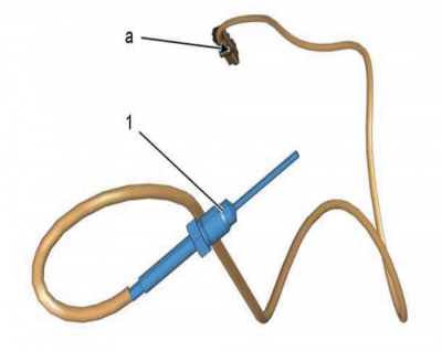

This fault is basically saying that the temperature readings are out of kilter:
Fault codeP2084
After sales description of the fault codeParticulate filter upstream gas temperature sensor: Voltage variation outside the tolerance
Description of the diagnostics
  • Electrical fault in the particle filter upstream temperature sensor
  • Variation in the temperature of more than 100 °C per second
Conditions of activation of the diagnosticsEngine running
Conditions of disappearance of the faultDriving with the engine hot for 5 minutes
Down-grade modes if fault presentDeactivation of the request for regeneration of the particle filter from the diagnostic tool
Switching on of the warning lamp and/or warning messageWarning lamp MIL
Main customer complaints likelyNo effects immediately perceptible to the customer
Suspect areas
  • Particulate filter upstream gas temperature sensor
  • Connector
  • Electrical harness
The above is the particulate filter upstream gas temperature sensor and its role is to inform the ECU of the temperature of the exhaust gases.
It is a NTC (Negative Temperature Coefficient) resistance value "R" which changes in relation to the change in the temperature "T":
  • When the temperature "T" increases, the resistance value "R" decreases
  • When the temperature "T" decreases, the resistance value "R" increases
Minimum
Tolerance ( °C)
Temperature ( °C)Maximum
Tolerance ( °C)
Resistance ( kohms)
90 °C100 °C110 °C96 kohms
140 °C150 °C160 °C32 kohms
190 °C200 °C210 °C13,5 kohms
240 °C250 °C260 °C6,3 kohms
290 °C300 °C310 °C3,3 kohms
340 °C350 °C360 °C1,85 kohms
390 °C400 °C410 °C1,15 kohms
440 °C450 °C460 °C0,755 kohms
480 °C500 °C520 °C0,514 kohms
530 °C550 °C570 °C0,362 kohms
580 °C600 °C620 °C0,268 kohms
630 °C650 °C670 °C0,198 kohms
680 °C700 °C720 °C0,151 kohms
So I would check the connector first and if it is suspected as faulty then you have the information for a replacement.

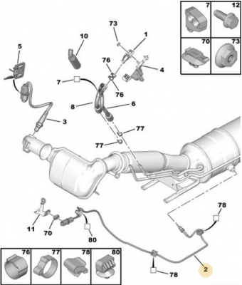

1618KP is the part number, item 2 below in the parts diagram:

There was a recall listed on some of the Citroens (Can't remember which exactly) where the harness had been badly routed and rubbed through on the hot exhaust, remedy was to replace the harness and re-route it.
x 6954
Re: 508 2.0 hdi engine warning light
I think that was mostly on the Relays and a few other older vehicles - no recall listed for this on the 508, but worth checking that the probe is properly secured and the cable is not touching the exhaust.
