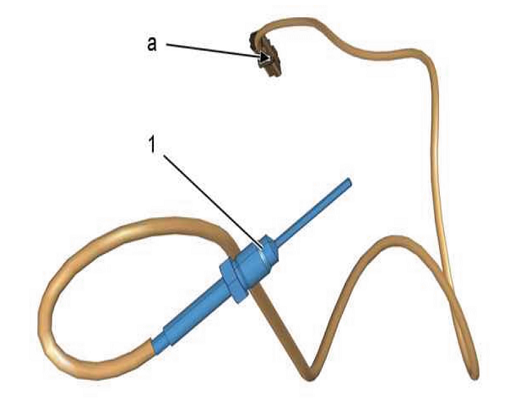

The above is the particulate filter upstream gas temperature sensor and its role is to inform the ECU of the temperature of the exhaust gases.
It is a NTC (Negative Temperature Coefficient) resistance value "R" which changes in relation to the change in the temperature "T":
  • When the temperature "T" increases, the resistance value "R" decreases
  • When the temperature "T" decreases, the resistance value "R" increases

So I would check the connector first and if it is suspected as faulty then you have the information for a replacement.
1618KP is the part number, item 2 below in the parts diagram:
