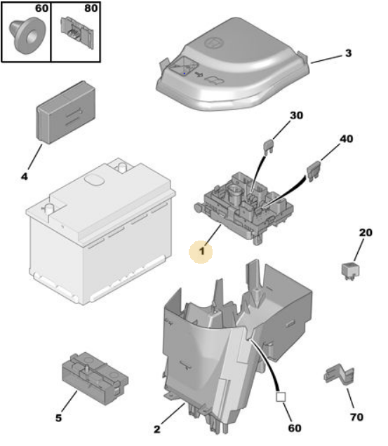

- x 6945
Re: 307 starting problem.
I'm not suggesting your issue is a fusebox without a diagnostic, but the part for the engine fusebox is 6500CK, item (1) below:
