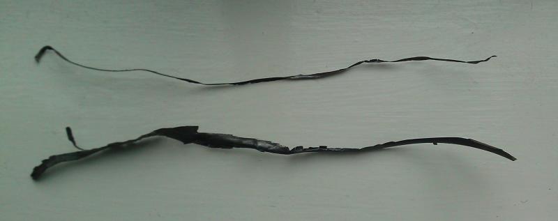

This is the scrap metal we removed, it was wrapped around the tensioner. Its came from somewhere on the car ...

There's an old thread with a similar picture Chris - the outer edge of the crank pulley stripped off IIRC.

It was indeed the crankshaft pulley which had failed. However, there is now a new problem ...
