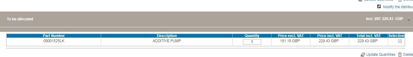

Thank you, I’ll order a new pump.
Forum Treasurer
Posts: 12566
Joined: 07 Aug 2002, 17:12
x 1485
Re: Additive not working
Unread post by RichardW »
service.citroen wrote:
:evil: ouch! might be worth seeing if you can get a 2nd hand one - I've not heard of one failing before, so they seem to be pretty reliable. It does say 'part to be configured' so it may need some Diagbox time - and there is a diagnostic repair procedure for priming the pump in there as well.
