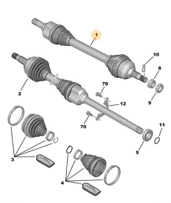

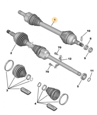

Here's the parts diagram for the X7 163.
(1) Is the left driveshaft and the OEM Part is: 3272SZ £541.81
or an exchange is part: 3272TA £473.48
(2) Is the right driveshaft, OEM is part: 3273TP £622.80
Exchange is part: 3273TQ £589.56
(3) is the Wheel side Gaiter Kit, Part: 3293C8 £55.26
(4) is the Axle side gaiter kit, Part: 3287C9 £35.96
All inc. VAT
