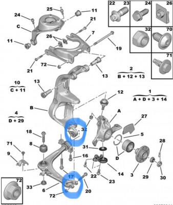

I had this in the driver side and it was the lower bush on the Front Pivot Support, which I’ve highlighted in blue.
They don’t sell the bush separate, but these can be ordered for about a £10 and replaced. When on the 4 post lift, the mechanic could lever the pivot back and forward with a struggle, and we could then see the movement and here the clunk as it moved back and forward against the metal. So with the weight of the car on he road it was more pronounced.

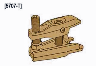

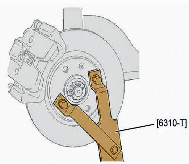

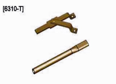

6310-T: Hub Immobilising Tool5707-T: Swivel Ball-Pin Extractor

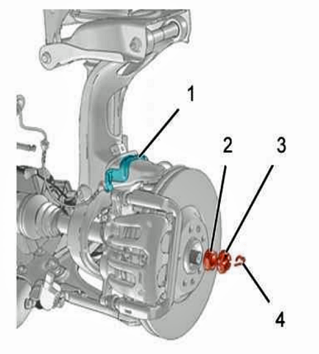

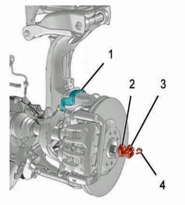

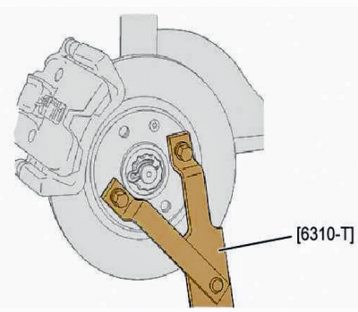

CAUTION: Never brake to slacken the drive shaft nut.
Fit the tool [6310-T].
Remove:
  • The pin (4)
  • The steel cage (3)
  • The drive shaft nut (2)
  • The tool [6310-T]
  • The bracket (1)

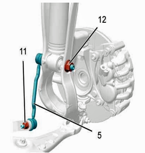

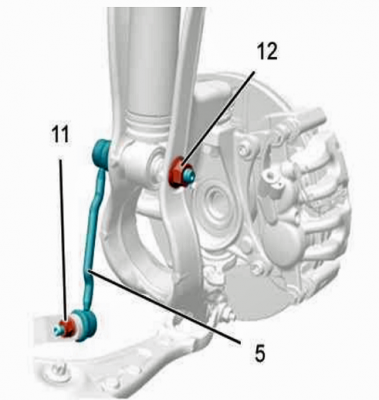

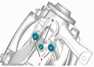

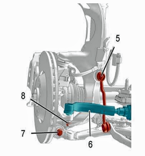

Remove:

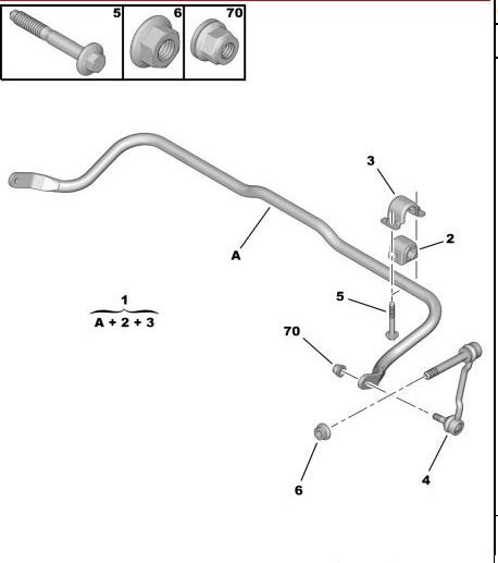

  • The anti-roll bar link rod (5)
  • The nut (8)
  • The mountings (7)
Uncouple the steering ball joint (6); Using tool [5707-T].

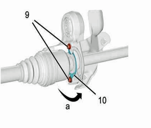

Left Hand Driveshaft
  • Release the LH driveshaft by pivoting the front half-axle upwards.
  • Remove the L.H. driveshaft.
Right Hand Driveshaft
  • Undo the 2 screws (9) of the RH driveshaft bearing.
  • Move aside the circlip (10) in the direction of the arrow "a".
  • Release the RH driveshaft by pivoting the front half-axle upwards.
  • Remove the right-hand drive shaft.
  • The nut (11)
  • The nut (12)

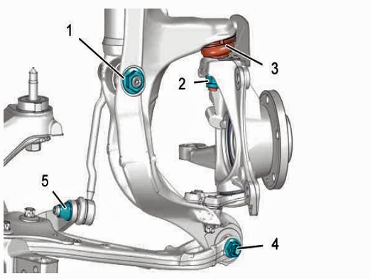

ReferenceDesignationTightening torques
(1)Nut (Front anti-roll bar rod / Pivot support) (*)20,5 daNm
(2)Nut (Pivot upper ball-joint) (*)6 daNm
(3)Pivot upper ball-joint / Pivot support (*)20 daNm
(4)Bolt - Nut (Lower suspension arm / Pivot support) (*)7,5 daNm
(5)Nut (Front anti-roll bar rod / Front anti -roll bar) (*)5,5 daNm

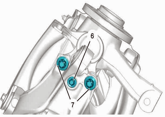

(6)Bolt (Front pivot lower ball-joint / Pivot support) (*)6,5 daNm
(7)Bolt (Front pivot lower ball-joint / Pivot support) (*)17 daNm
* CAUTION: The "Low Friction" bolts (or nuts) (1), (4), (5) are only for single use and must always be replaced. All re-use is prohibited (risk of breakage). The bolts (or nuts) removed must be thrown away.

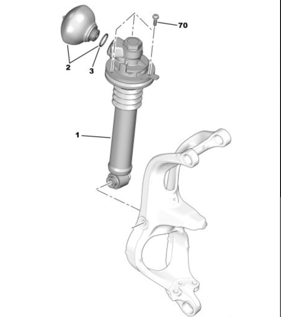

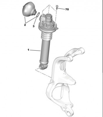

Just one last ask... Do you have part numbers for the Low friction bolts and nuts 1,4 and 5?
Regards Jim
x 6945
Re: 09 C5 x7 2.0hdi Auto Driveshaft replacement
I had a feeling that was coming 😃

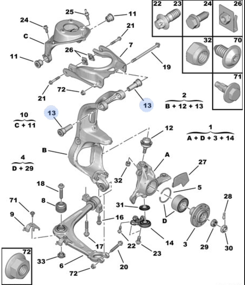

Part no: 693684 lower ARB nut. (5)
Part no: 693665 (4)

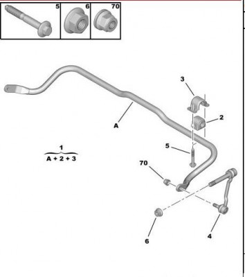

Unfortunately, I cannot for the life of me find the nut for item (1), which actually secures the suspension strut to the lower pivot. As you can see, in the following parts diagrams, the whole Pivot support (B) does not show the nut fixing - but it can be seen on the strut diagram - only there is no nut sold separately, so I wonder if this is part of the strut ....
Have a check with the local dealer when you ask about the other part numbers. At least you can show him the diagram, and I’m sure he will be impressed that you have the info.

It's part of the roll bar drop link, Marc:
