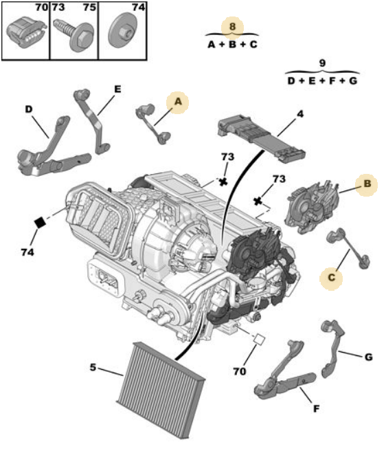

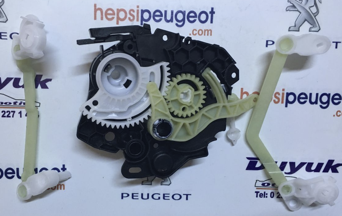

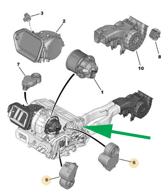

Ok, so here are the sections of the heating gear. These are slightly different to some other models in that they have 'rods' .
| The reduction gear modules are at 6 & 7 | 8 & 9 are replacement kits |
| Here's a close up of one of the internals and is the unit on the diagram that I have arrowed in green. |
