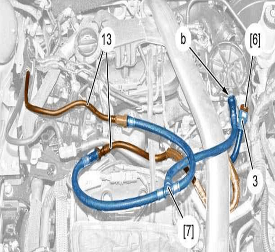

This is just the part of the process after you have refitted it. You need the diesel filter draining union that it refers to as (7):
Couple the female union (Ø 10 mm) of the tool[7] in place of the pipe (3), as "b".
Disconnect the fuel return pipe (13) and insert the union (Ø8 mm) of the tool [7] into the fuel return circuit.
Switch the engine on and off 10 times in order to fill and bleed the fuel filter.
Remove:
The tool [7]
The tool [6] from the pipe (3)
Couple up pipes (3) and (13).
Switch the engine on and off 2 times.
Remove:
The tool [7]
