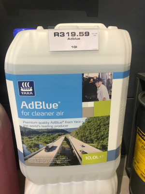

Another question. I saw a product called ‘Adblue’. I guess it won’t suffice for our use? I believe it has the same purpose as Eolys?

Hi Corne - I will get something to you tomorrow - but NOOOOOO! Don't put that stuff anywhere near your vehicle.
It's not Eolys or or any other type of particulate filter additive - it's basically cow pee or urea. It is only used in later vehicles with SRC technology. That's Selective Catalytic Reduction. It basically gets injected into the special catalytic converter to eliminate the NOx. Then the particles get dealt with by the diesel particulate filter in the normal way using a Cerine-based additive like Eolys.
Normally found in the Blue HDI vehicles from 2013 on. These have an Adblue tank and a DPF tank, but have completely separate functions.
