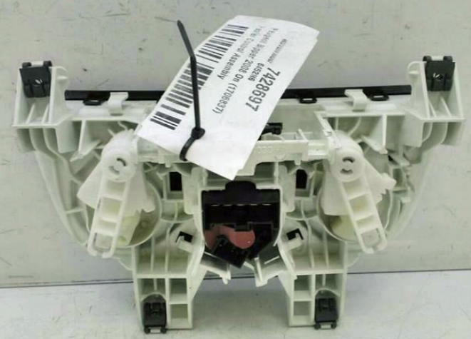

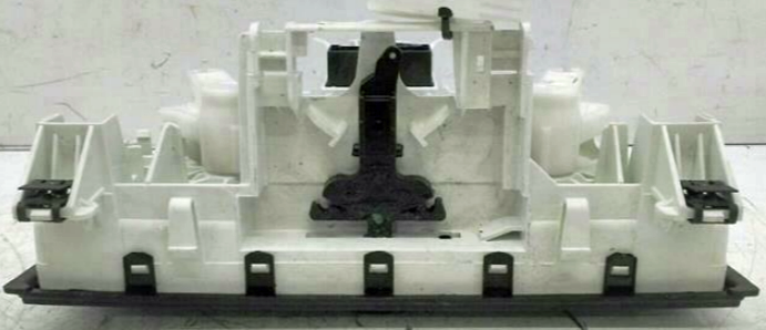

Ok, so this is the unit you have - although there are no obvious indications of a bulb from the pictures below - these do have some form of lighting - so you may need to examine or unclip the black cover to see if they are inside.

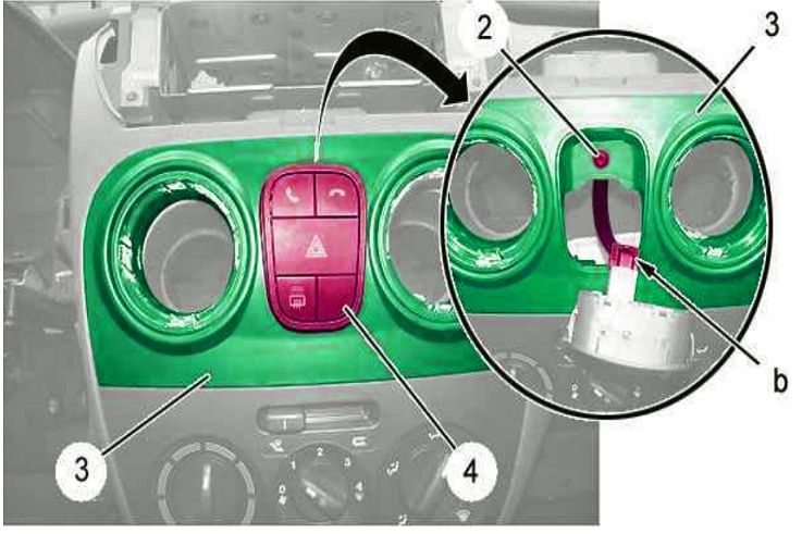

Here is part of the fascia removal procedure to get the panel off - but be careful, as there are manual cables attached to the dials that operate the heater controls.

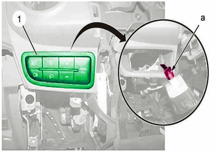

Unclip the dashboard vents.
Unclip the plate (1).
Disconnect the connector ( as "a").
Remove ye plate (1).
Unclip the centre panel control pad (4).
Disconnect the connector ( as "b").

  • The centre panel control pad (4)
  • The (2) bolt
  • The centre panel trim (3)

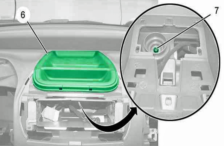

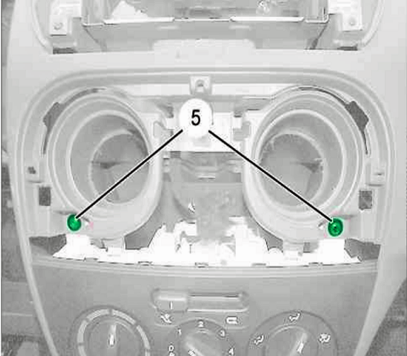

Remove the bolts (5).Unclip - Remove the fascia panel upper trim (6).
Remove bolts (7).

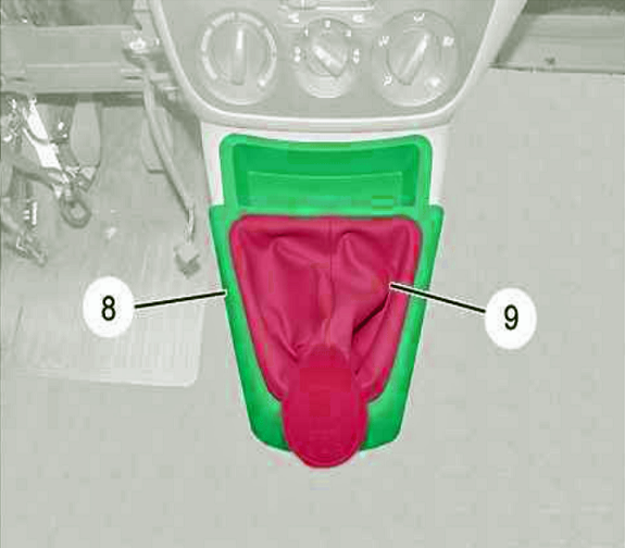

Unclip the gear lever gaiter (9).
Remove the gear lever (8) base trim.

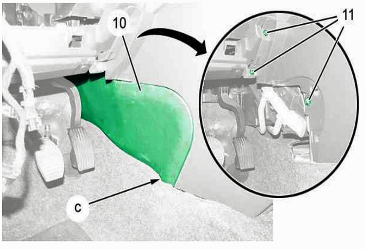

Unclip - Remove the fascia left-hand lower trim (10) ( as "c").
Remove the bolts (11).
N.B. : Symmetrical operations.

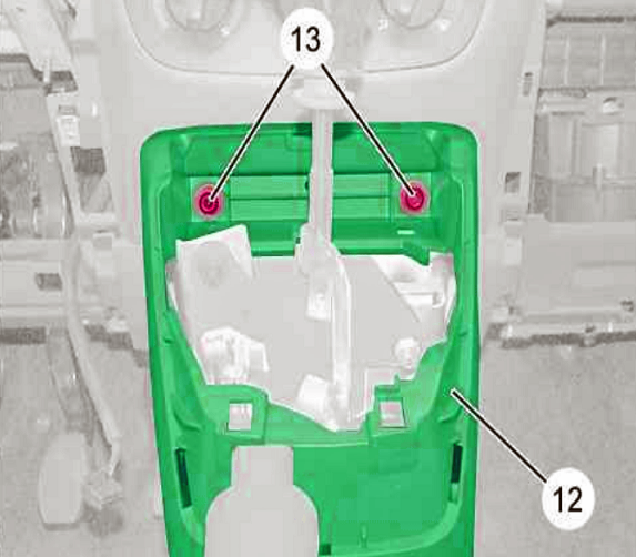

Remove:
  • The bolts (13)
  • The fascia lower central trim (12)

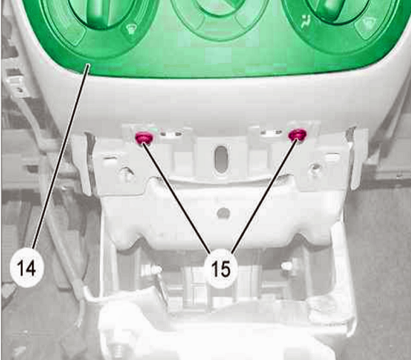

Remove the bolts (15).
Detach the air conditioning panel (14).
