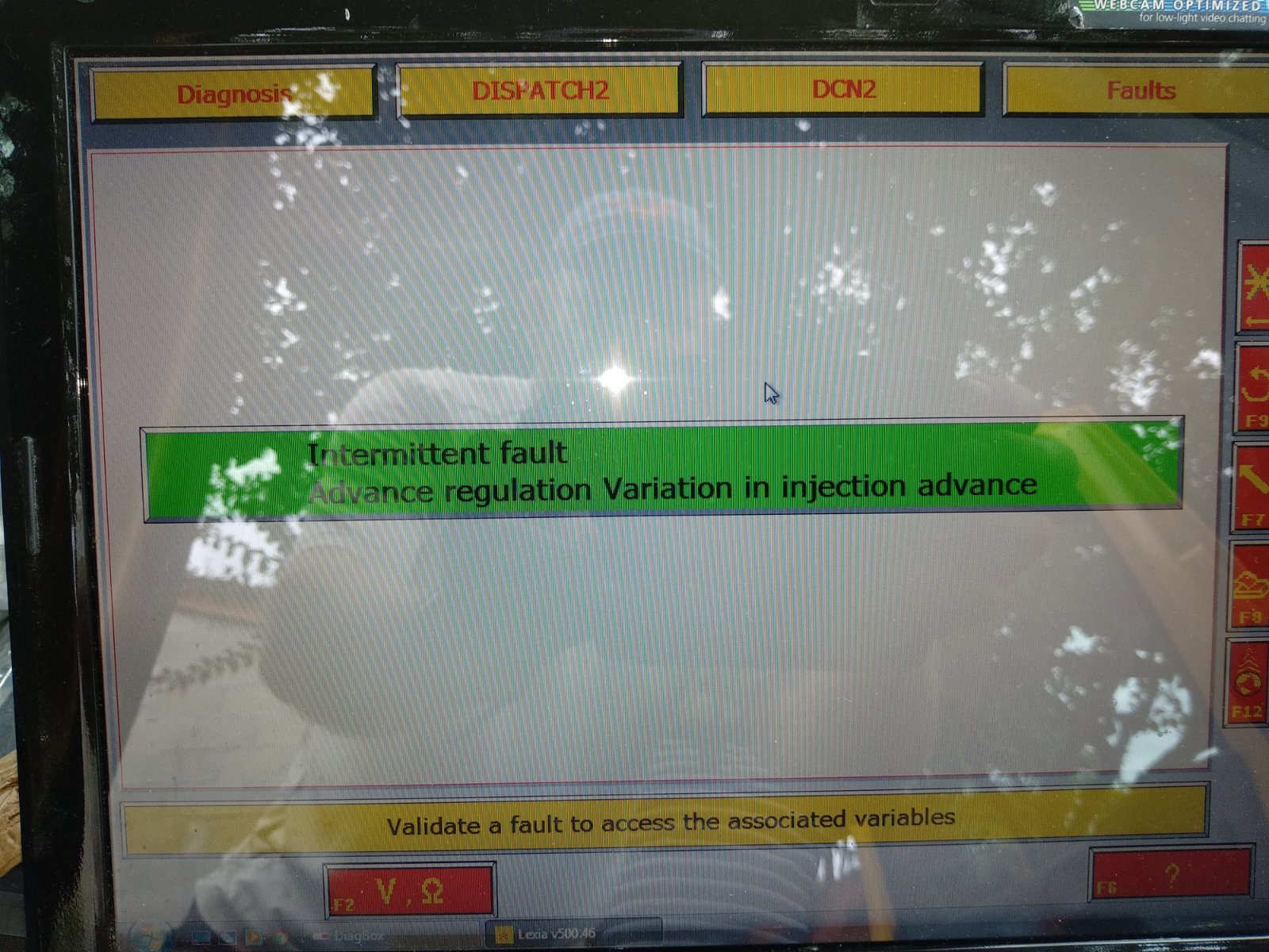

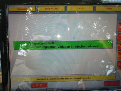

Borrowed my friends lexus and ran the fault test. It came back with
P0170 intermittent fault, advance regulation, variation in injection advance.

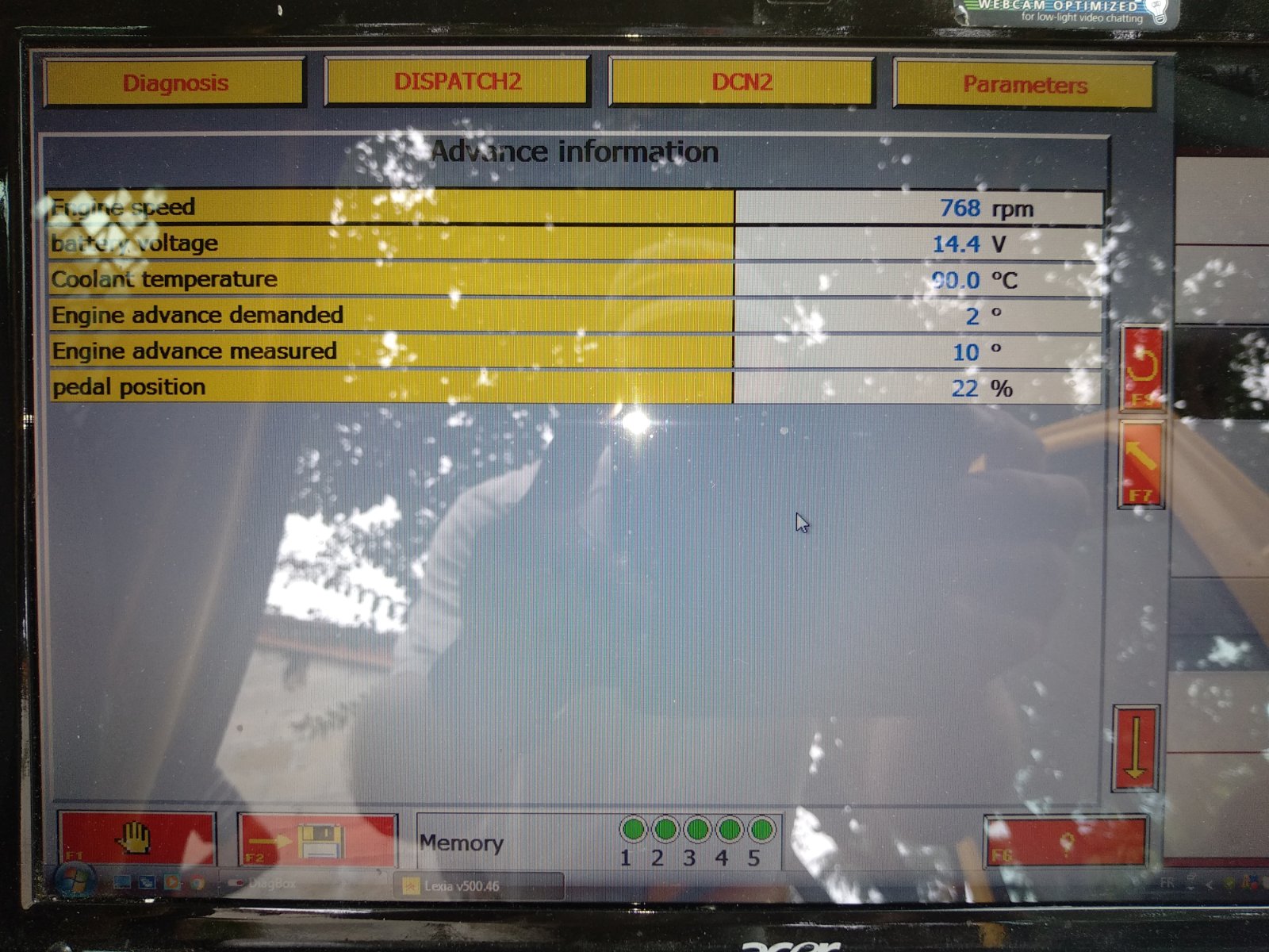

Looking at the live data and the engine advance readings. When idling the engine advance demanded is 2° but the engine advance measured is 10°. The engine warning light is on.
If I then rev the engine slightly to around 1300 revs the figures of demanded and measure are in step or very close to each other and after a couple of seconds the warning light on dash goes out. If then I release the accelerator it goes back to values of 2° and 10° and the warning light comes on again.
Here are the readings at idle

You have DW8B engine: DISPATCH I & II TYPE 800 VAN SHORT 1.9 D 71 (DW8B) Manual gearbox 5
So the fault lies with the advance actuator and is classified as a major fault. A backup mode will be initiated - in this case cutting of the EGR valve. A difference of 7 degrees between the requested advance and the measured advance shows that the ECU is not managing to control the advance. Check the initial timing of the injection pump and if not this, then it is an internal injection pump fault.
