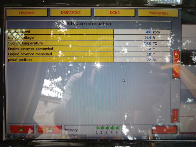

Looking at the live data and the engine advance readings. When idling the engine advance demanded is 2° but the engine advance measured is 10°. The engine warning light is on.
If I then rev the engine slightly to around 1300 revs the figures of demanded and measure are in step or very close to each other and after a couple of seconds the warning light on dash goes out. If then I release the accelerator it goes back to values of 2° and 10° and the warning light comes on again.
Here are the readings at idle
So the engine warning light seems to start comes on at idle when the engine is warm. Also whilst driving I get the light on Intermittently normally when the engine under load. For example when I am going up a hill on 4th and I should be thinking of changing into 3rd.

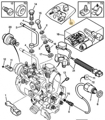

The advance solenoid is a separately replaceable part. I have changed quite a few of them on DW8's, the normal symptoms when they fail are loss of power & engine rattle that sounds like the engine has no oil in it but normally goes away when the engine is switched off & back on again. It only takes minutes to change it, Just literally unscrews out, I remember they used to be very expensive but just had a look on servicebox & it looks like they have went up even more in price. I don't have the chassis number to confirm the correct part no but if its 1563L1 then they are now eye wateringly over £500. Im sure they used to be around the £280 mark.

Yes that's the part: 1563L1, item 22 - £508.40 from Citroen inc. VAT, but plenty of others here:

This Part doesent need any coding, what you have read you are confusing with part 18 in the picture which is a coded part.
