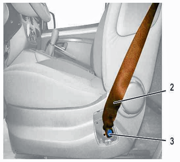

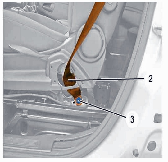

Ok, so you have (or will be getting) a NEMO UTILITY VEHICLE VAN 1.3 HDI 75 Manual gearbox 5.
The front right belt has part number: 1613972380 and the left one is: 1613972980.
Before removing the belt, you must disconnect the battery negative terminal and do not allow it to make contact. Then wait 10 minutes to allow the Airbag Control System capacitors to discharge. Usual warnings apply - don't use any powered measuring instruments on the pre-tensioner and don't carry the belt by the wire.
You will have one of two seat belt assemblies - it depends on your vehicle, so I've included both assemblies:
You may well have to remove the 'Cab Partition' to get at the Post trims and some of the window seal trim may also be necessary.
Next you'll need to remove the B Post trims, after removing the floor sill trim:

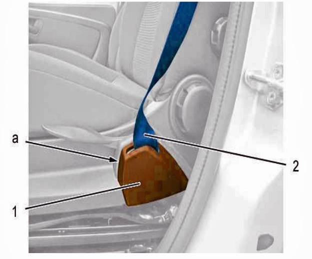

Enter the seatbelt (2) into the cover (1).
Clip: The cover (1).

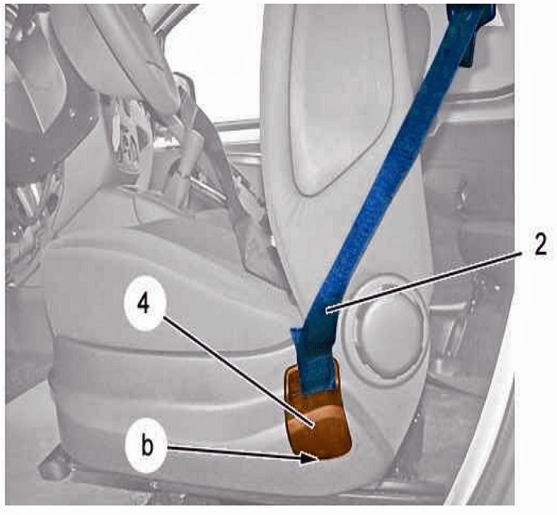

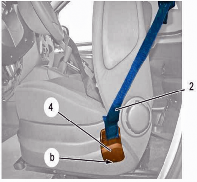

2nd assembly
Enter the seatbelt (2) into the cover (4).
Clip: The cover (4).

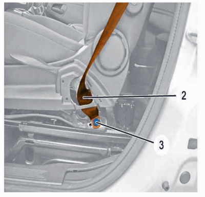

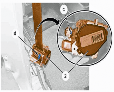

| 1st Assembly Unclip the cover (1) ( as "a") ; Using tool [1]. Release the seatbelt (2) from the cover (1). Remove the cover (1). | Remove:
| 2nd Assembly Unclip the cover (4) ( as "b"), using trim removal tools [1]. Release the seatbelt (2) from the cover (4). Remove the cover (4). | Remove:

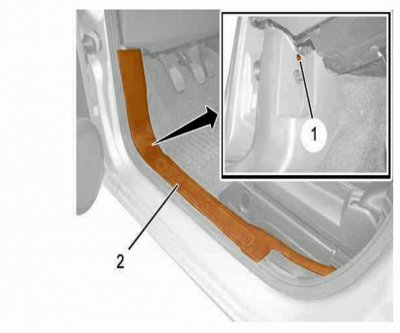

| Remove the bonnet release control. Remove bolts (1). Unclip and remove: The door sill trim (2). |

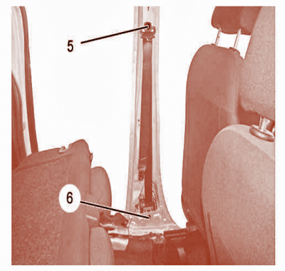

| Remove the bolts (5), (6). | Disengage the front seat belt reel (2). Unlock the connector ( as "c"). Disconnect the connector "d". Remove the seat belt (2). |
Connect the connector "d".
Refit:
- The seat belt inertia reel (2)
- The bolts (5), (6), tighten to 4 daN.m

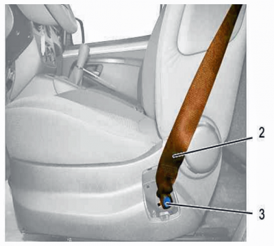

- The seat belt (2) (lower part)
- The (3) bolt, tighten to 4 daN.m
2nd assembly
