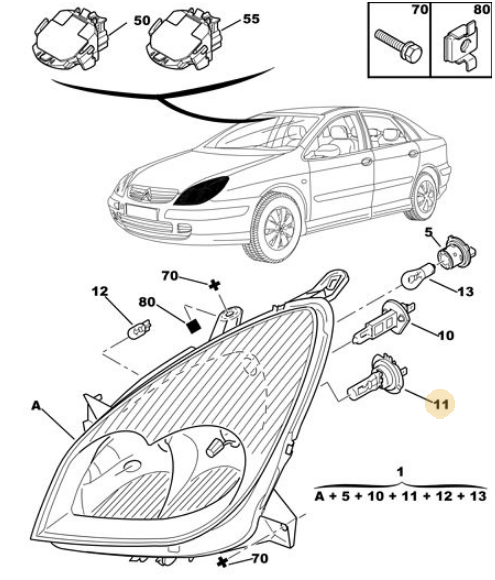

Re: Citroen C5 I - Xenon Headlight Question
Ok, so you have 2 main bulbs for the headlights - one is the Xenon (11 on the diagram) which is a D2R bulb and the other is an H1 55W bulb (number 10).
A word of caution - I strongly suggest you avoid ebay and Amazon for these D2R bulbs - as it's estimated that a very high proportion are fakes and will not be originals!
I recommend OSRAM - and get them from an approved reseller or authorised reseller to avoid Chinese copies that are not of the same quality and will not last as long.
