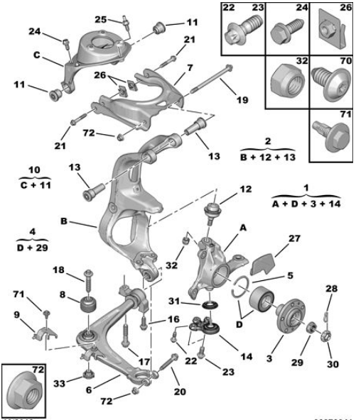

just had another look, looks tough!

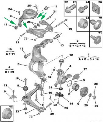

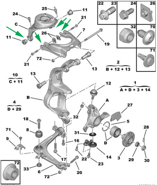

have you got a official how-to on removing the strut mount? dont worry if its buried and a load of hassle. The bushes look to be part of the strut mount - not the upper arm!
is the diagram linked before able to be a bit bigger? I cant seem to zoom on it, click it etc?

On any of the pictures / diagrams within my specific posts, they will zoom if you click on them John. So just to be clear, which part are you replacing?
jgra1
(Donor 2021)
Posts: 4625
Joined: 27 Nov 2005, 19:07
x 36
Re: X7 front upper arm - inner bush replacement
Unread post by jgra1 »
! that's better :) the other pic wont do that
part 11 :)

Replacing Bushes: Front Suspension Upper Support
Procedure Specifically for Citroen C5 X7 DW10CTED4 with Hydraulic Suspension Only
The bushes are shown at (11) on the diagram (click to zoom)

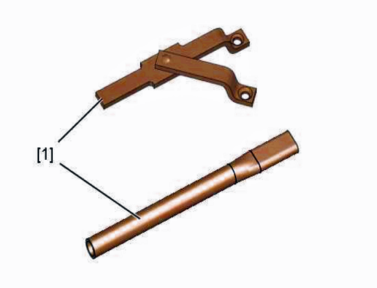

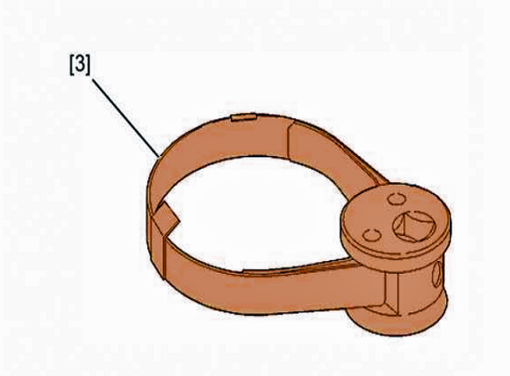

Tools
[1] Hub Immobilising Tool 6310-T.[2] Ball-Joint Extractor 1892-T.[3] Spanner for removing "Slimline" spheres 8611-T.

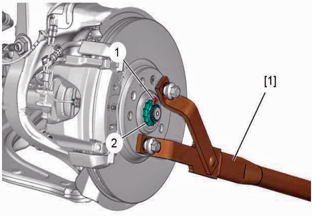

Fit the tool [1].
  • The pin (1)
  • The cover (2)
  • The drive shaft nut (/)
ESSENTIAL: Never brake to slacken the drive shaft nut.

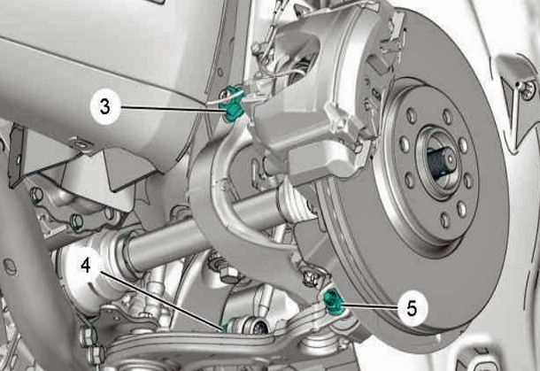

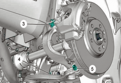

Remove:
  • The nut (3)
  • The nut (4)
  • The nut (5) and its pin
Remove:

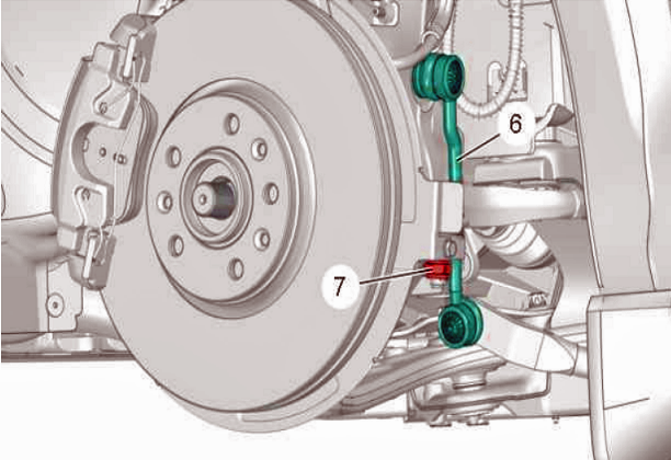

  • The anti-roll bar link rod (6)
    The nut (7)

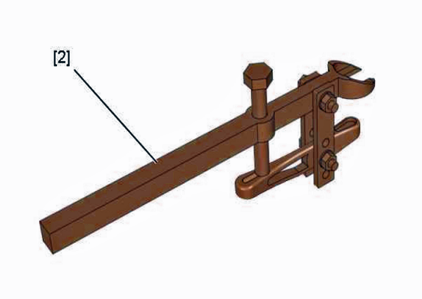

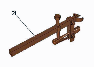

Uncouple the steering ball joint: Using tool [2].

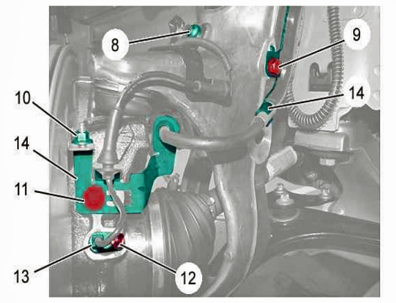

Remove:
  • The (8) bolt
  • The (9) bolt
  • The nut (10)
  • The (11) bolt
  • The (12) bolt
  • The ABS sensor (13)
Move aside the brake hose supports (14).
Hold the driveshaft at the gearbox end (left side).
CAUTION: Hold the end of the driveshaft to prevent an excessive angular travel (Risk of uncoupling).

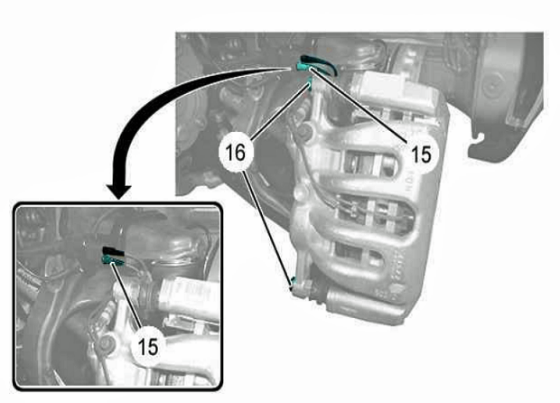

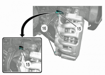

Disconnect: The wires of the brake pad wear indicator (15).
Remove:
  • The bolts (16)
    The brake caliper
Disengage the top part of the caliper between the pivot and the pivot support, in order to prevent the braking circuit from opening.

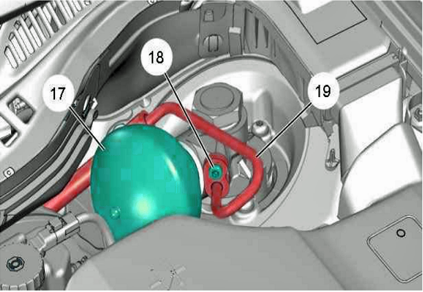

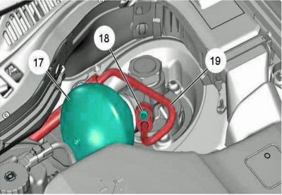

  • The suspension sphere (17), Using tool [3]

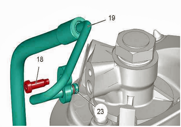

    The (18) bolt
Uncouple the high pressure piping (19) from the suspension cylinder.

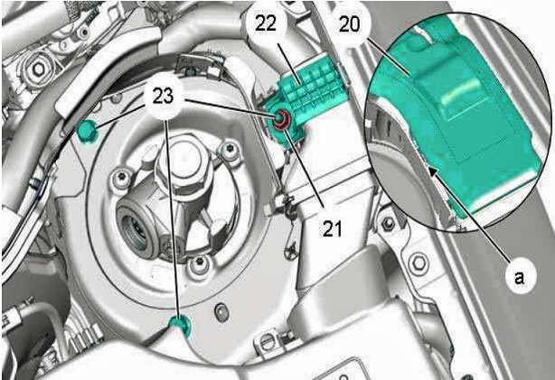

Move aside the protector (20) (at "a").
Remove:
  • The nut (21)
  • The bracket (22)
  • The bolts (23)
  • The front suspension leg

N.B.: Refit a new seal (23).
Couple the high pressure piping (19).
Refit:
  • The (18) bolt, Tighten to 2 ± 0.2 daN.m
  • The suspension sphere (17), Tightening to 2.7 ± 0.2 daN.m
  • The nut (4)
  • The nut (3)
  • Fit a new nut (7).
Tighten the nut (7) to 4.8 ± 0.5 daN.m.

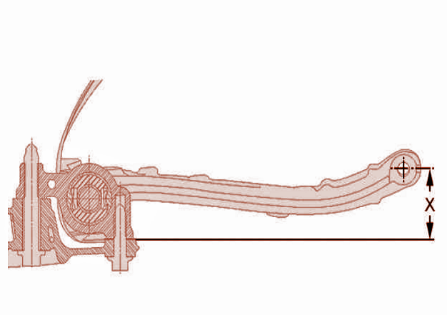

"X" = 58 ± 5 mm.
Position the front suspension lower arm to the dimension "X".

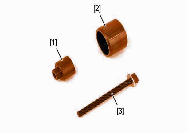

Tools
[1] removing mandrels (-).0548.A4.
[2] removal cap (-).0548.A3.
[3] guide bolt (-).0548.A1 + washer M10 (-).0548.A2.
[4] Refitting ring (-).0548.B3.

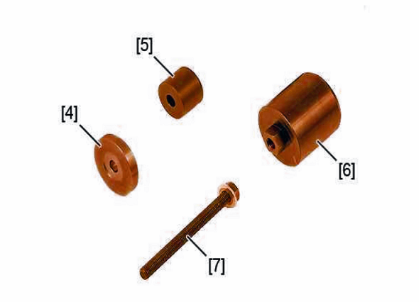

[5] refitting guide (-).0548.B4.
[6] refitting cover (-).0548.B5.
[7] guide bolt (-).0548.B1 + washer M10 (-).0548.B2.

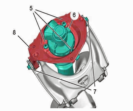

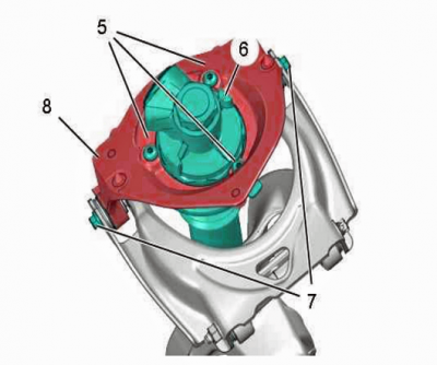

Remove:
  • The bolts (5)
  • The front suspension cylinder (6)
  • The bolts (7)
  • The front pivot upper support (8)

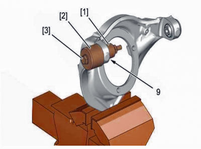

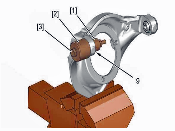

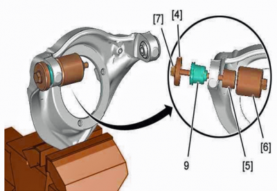

Immobilise the front pivot support in a jaw vice.

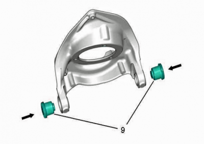

Fit the tools [1], [2], [3] on the front flexible mounting (9).
Extract the flexible mounting (9) by screwing in the screw of the tool [3].
Tighten the screw [3] to extract the rubber bush (9).

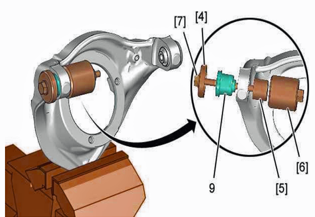

Refitting

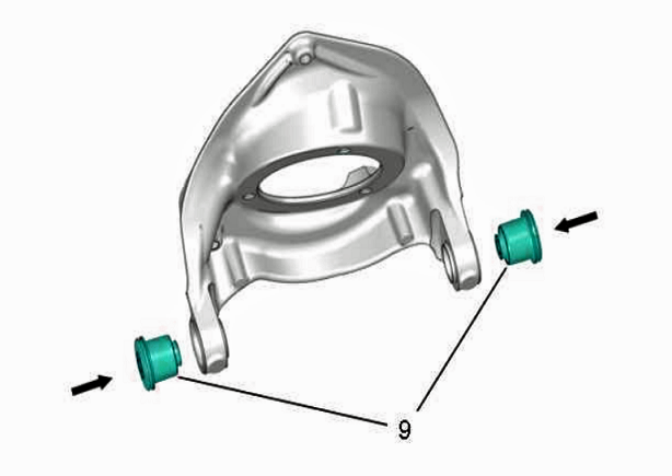

CAUTION: Respect the direction of fitting for the rubber bushes (9).Fit :
The new rubber bush (9)
Tools [4], [5], [6] and [7]
Tighten the bolt [7] until the rear flexible mounting (9) is put in place.
CAUTION: The fitting of the flexible bush must be done with some force. If the rubber bush is loose, replace the front pivot upper support.
Refit:
  • The bolts (7) (Without tightening it)
  • The bolts (5) (Without tightening it)
Tighten in the correct range:
The bolts (7) to 4.5 ± 0.6 daN.m
The bolts (5) to 2.4 ± 0.3 daN.m
