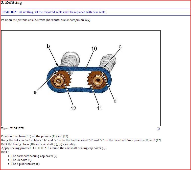

Also a second question. The chain between the two camshafts doesn't seem to have any visible different coloured links to do the timing that I can see. The timing is all out. Any advice? Are there marks on the sprockets when I do get it apart?

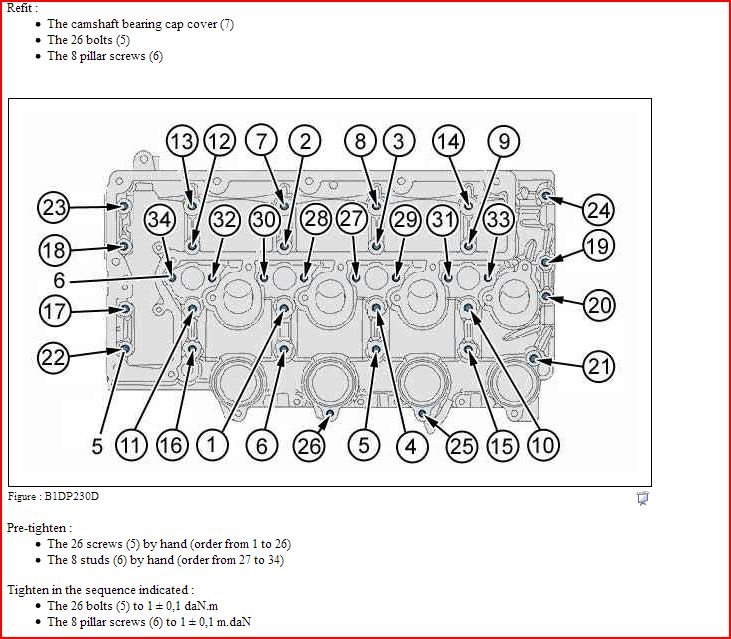

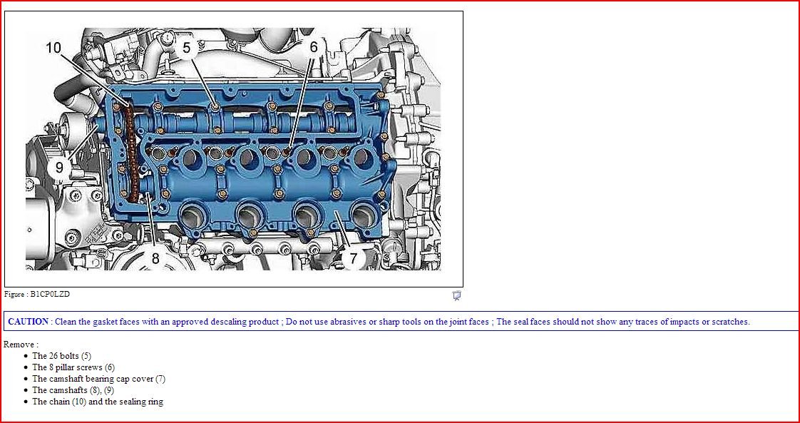

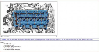

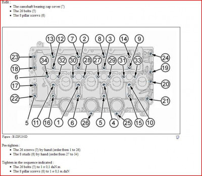

Nothing special listed...
Timing - there should be 2 black marks on the chain, but if the drawing is right it's just 6 links between the marks on the cams.
Tightening sequence for cam carrier
