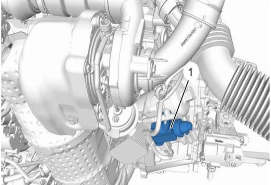

Ok, so you have the DV6ETED4 engine with Bosch EDC17C10 Engine ECU.
The fault as it relates to your vehicle is:
Fault: Turbocharger: Position incorrect relative to requirement, not enough turbo. The position measured is greater than the reference by more than 20 % for 4 seconds.
Fault Triggering: Engine Running, Engine speed between 1500 and 4000 RPM
Fault Disappearance: Driving for 5 minutes.
Symptoms:
It's located here:
Symptoms:
- Noise
- Smoke from the Exhaust
- Lack of Power
- Loss of Braking
- Turbocharger
- Turbocharger fixed geometry control electrovalve
- Turbocharger fixed geometry position repeat sensor
- EGR exchanger with bypass
- EGR exchanger bypass control solenoid valve
- Vacuum pump
- Electrical harnesses
It's located here:

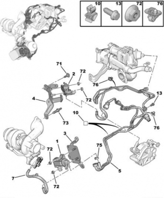

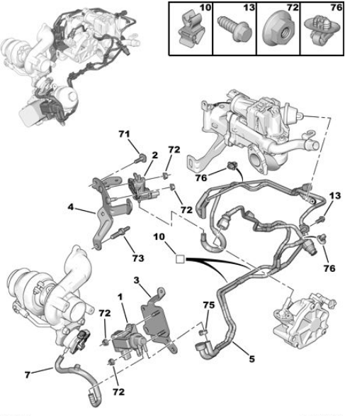

- x 6950
Re: berlingo p2562 error code
Yes, it's part number: 9811643880 and is shown as item (1) on the diagram below.
It is priced £42.77 inc. VAT from Citroen using the part number above, but you may be able to source one on the aftermarket - but if it's too cheap don't bother as the quality might not be up to much.
This is a suggestion only - as you can see from the suspect areas that there are a few possibilities. If you have a friendly mechanic, then they may be able to test the electrovalve for sufficient vacuum. As with all troubleshooting there is rarely a definitive 'it's this or that' - only a pointer as to the possible culprit. But given that a turbo is a few quid short of £1000 it;s worth exploring the cheaper fixes first.

code cleared soon as i started the engine, part no is on the sensor itself, while it was dangling i could see it. googling 9801887686 brought up a number of them. thanks again Marc.
- x 6950
The part number is the one I listed earlier, so maybe this has been changed before for an incorrect one, so stick to the part number I supplied you as that is the official part number according to your VIN. They all have different specifications.
