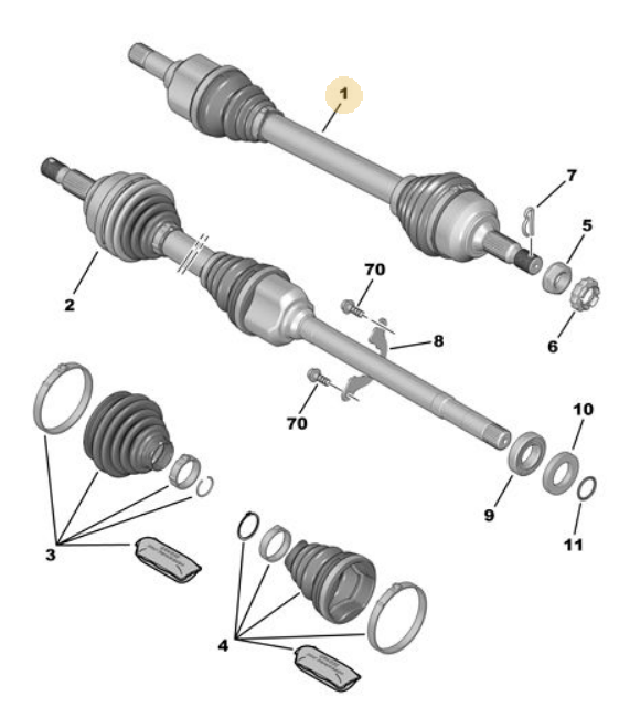

Here you go:
Item (1) Left, New, part 3272RZ, £520.21
Exchange, part 3272SA, £448.98
Item (2) Right, New, part 3273SN, £482.27
Exchange, part 3273SP, £463.56
These are Citroen prices inc. VAT and each has an additional refundable surcharge of £66.96 on top of these prices.
So for non dealer new parts, focus on part number 3272RZ or 3273SN depending on left or right in your search.

Re: C5 x7 cv joint automatic gearbox
The OP was asking for the outer CV joint, Marc. It doesn't seem available on the drawing you've posted, just the boot kit.
You probably cannot (from Citroen, at least) buy the CV joint; it looks like they only do the whole drive shaft.
They’re not available separately from Citroen Paul, hence the expense, as they are complete shafts.Paul-R wrote: 01 Aug 2019, 15:44 The OP was asking for the outer CV joint, Marc. It doesn't seem available on the drawing you've posted, just the boot kit.
