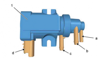

Here's a close up of the valve:
(1) Proportional electrovalve.
"a" Vacuum inlet.
"b" Vacuum outlet.
"c" breather.
"d" 2-way black connector .
make: BITRON/PIERBURG.
The solenoid valve is a solenoid valve that is normally closed.
These all vary slightly in appearance - there are videos out there on taking these off and cleaning the gauze or sponge filter - depending on type.
If you have a vacuum testing kit you can use that to check pressure - incase you need the part number, it is 9801887680 - which is for the DW10CTED4 engine. Post your VIN up and I can confirm the part number.

Sorry I forgot to mention that I changed the electrovalve but still have the same problem, unless I have been unlucky to get another faulty one. I could try swapping Number 5 with Number 4 on the valve side of things. My intake has the hot air side blanked off on both the air union and the air doser. I will see if I can get under the car at some point to visually check the movement of the actuator. Because the turbo is at the back of the engine, its a pain to get to :( It did occur to me that when I had an injector problem where the car wouldn't start, I had white smoke coming out from the back of the engine. I have also had a report from the garage previously that they have noticed some sooting on the exhaust side of the turbo. Would this have an effect on sensor readings?

I managed to find a spare hour today so I decided to take apart the piping (no 7) and check it over. It was all fine and air was getting through no problem.. I decided whilst I had most of it apart, I would swap the solenoids to see if it would make a difference, then went on a drive on the A road.. What a difference so far! I can pull away and take it right up to 4k rpm and have no code and the boost feels a bit more even than before. Also the juddering seems to have reduced somewhat. The only downside is that I now get a P0488 code come up relating to the EGR valve (which has been causing the juddering). It was a brand new one fitted last year, BUT, the garage had to update the ECU software as the newer EGR only has one electrical plug on it as apposed to two. Its definitely a step forward so far!
x 6946
Re: Peugeot 5008 2.0hdi P11AA P0234 strange turbo noise
Ok, good, so you know the solenoid is dodgy - if you swapped the solenoid for the EGR one then the new error is probably relating to that. So try and get a decent solenoid valve to put back and you should be fine. Thanks for the update.
