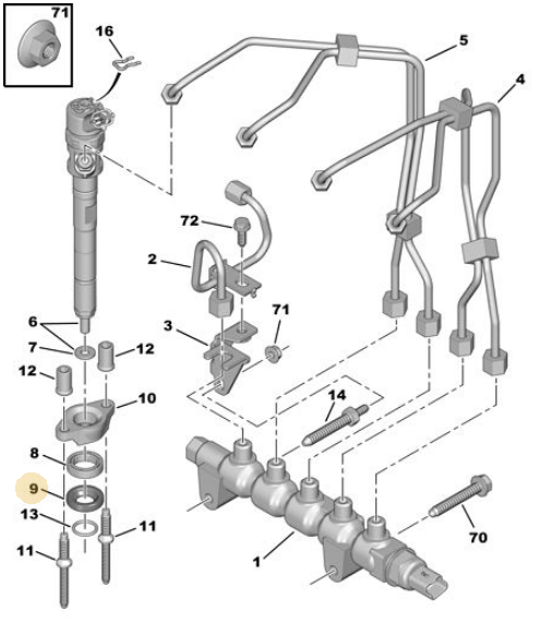

Re: Needing the part number of diesel injector seal for Citroen C4 Picasso 1.6 HDi
Here you go:
item (8) is the injector protector - Part 1609848080 £4.60
Item (9) is the injector seal - Part 1609848280 £5.77
Citroen prices inc. VAT when in.

Thanks that looks like exactly what I need, except I could do with the part numbers of 7 and 13 as well just in case. Citroen said they were able to get 3 of those 4 parts, but if a seller has all four online I might as well order from them instead.
I need all 4 of them as I couldnt even see them when I took the injector out!
x 6955
Item (7) is the Engine injector seal and that is part 1610564580 (Additional info: 7,3/16 EP 2 CN)
Citroen do a 4 pack of these (Part No: 198173)
Item (10) is the Fork and is Part No: 1609848680
