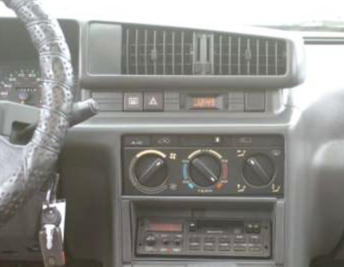

Hi, the rear heated screen button in my 405 is stuck down and I cannot turn it off. What would be the best way to fix this without snapping the button off and breaking it?
x 6957
Re: How would I fix a stuck on heater button?
The switch was available separately as a spare part, so must be removable. It probably is released from underneath the trim and if it's like the one in the picture below...
....then you'll probably need to get access to it from the radio recess - once it is removed and getting your hand up inside to release the retaining clips.

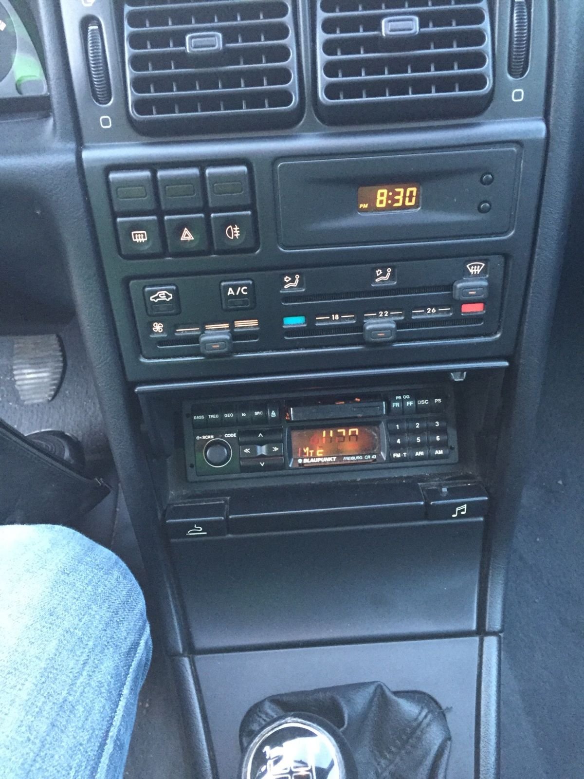

405chap101
Posts: 29
Joined: 25 May 2019, 22:56
x 3
Unread post by 405chap101 »
Mine's a later style dashboard, looks a bit like this one -
Is the procedure the same?

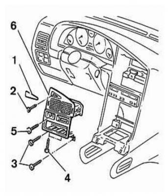

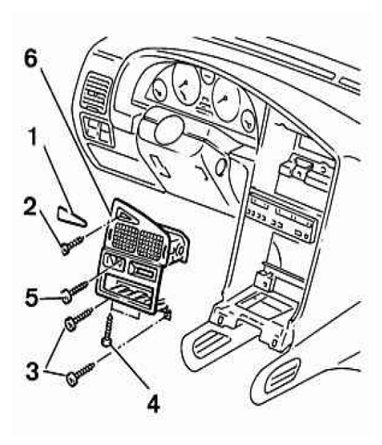

Ok, I was going to ask for your VIN to determine correct model - might still be useful for further questions..
Here is a picture of the switch itself - now I don't know whether it is possible to use a thin flat head screwdriver to move the lugs as shown on the switch to lever it out or not.
If not, this is how to remove the central console - you may not need to do all this, but should provide enough info to get near the switch if you can't lever it out.
Remove:
  • The floor console
  • The ashtray housing
  • The radio housing
Remove:
  • The blank (1)
  • The fixing (2)
  • The mountings (3)
  • The mountings (4)
Unclip the switches.
Remove the fastener (5).
Unclip the clock electrical supply.
Remove the centre panel ( 6).
