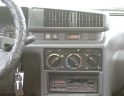

Mine's a later style dashboard, looks a bit like this one -
Is the procedure the same?

Ok, I was going to ask for your VIN to determine correct model - might still be useful for further questions..
Here is a picture of the switch itself - now I don't know whether it is possible to use a thin flat head screwdriver to move the lugs as shown on the switch to lever it out or not.
If not, this is how to remove the central console - you may not need to do all this, but should provide enough info to get near the switch if you can't lever it out.
