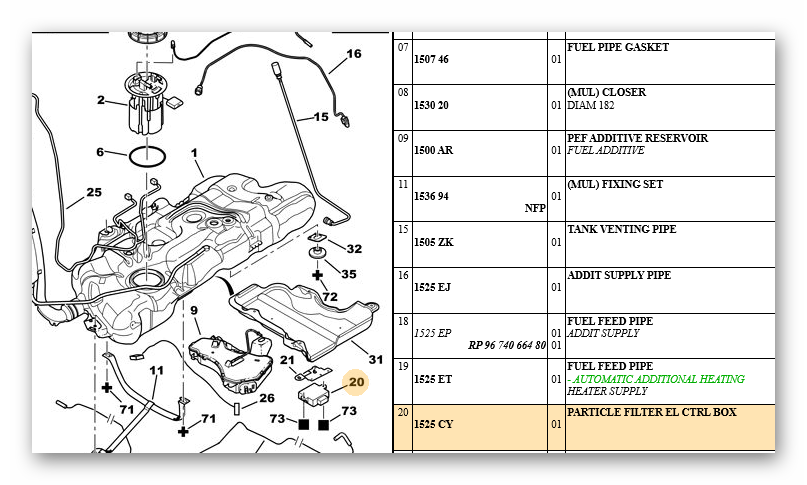

My scanner reports fuel neck sensor fault so I replaced it, it didn't fix it, I acquired the DPF ECU listed in Service Citroen new old stock, climbed under to fit it this morning, there no such thing in the place shown in the picture, so am I being wound up or is it somewhere else?
Item 20 in the image.

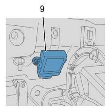

Oh, come on Gibbo, it's obvious from the diagram that it's behind the dashboard, to the left of the blower motor is't it?

Re: Wasting my time
If its fitted, yours will be in the OS sill by the rear door. move the carpet to check as its accessed from within the car itself

Re: Wasting my time
For the restyled C5 (MK II) it is to the left of the blower. If you have the version without the fuel cap sensor, then the engine ECU controls the additive pump. As he's having issues with the 'cap sensor', then almost a certainty he has the cap sensor version and therefore the separate additive ECU that on the C5 MK II is where I said.

Re: Wasting my time
That's a MK I and the location was different for the additive ECU on those models.
usually bottom of the 'B' pillar right hand side. I was just trying to save Eric from tearing up the interior of the car looking for something that won't be there - as he's already been round the houses under the car looking for it
