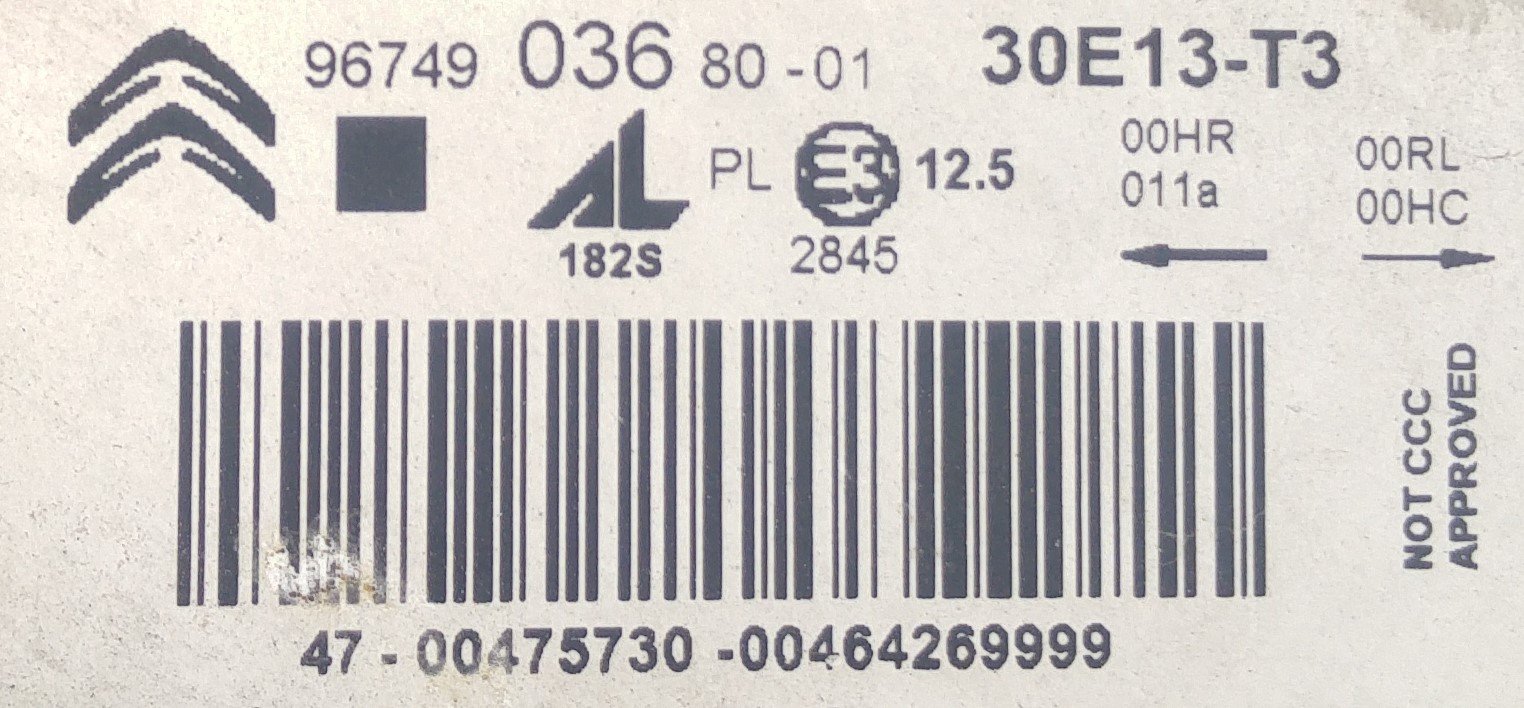

I've got the emanuals prog installed but it won't let me look at wiring diagrams without the RPO number.
I've spent hours Googling where to find it, which is how I ended up here.
I found a post from 2010 about this. I can't find anything on my car that resembles an RPO number.

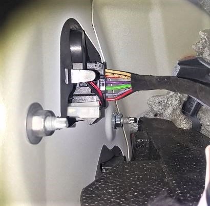

I've attached some photos in hope.
Thank you.
John.
The colours are, from the top -
2 x mustard?
1 x red
1 x purple
1 x green/yellow
1 x grey
1 x brown
The labels are all I can find anywhere on the car.

The rpo is usually on the tyre pressure sticker
- x 6950
Re: Rear Parking sensors wiring
Your RPO is 13365
For the rear LH lamps on the BODY, yellow and green is the common earth for all the lamps on that cluster.
on the left hand side, Pin 2 is the reverse feed, with the earth in pin 3
on the Right Hand rear Body unit, the reverse is Pin 5 with the earth in Pin 4

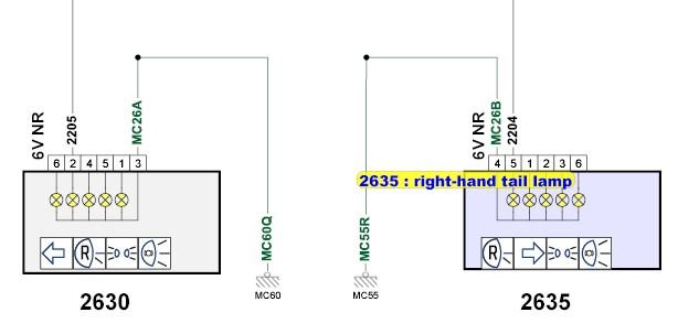

I've attached the drawing from the emanual.
I'm assuming you are counting brown, on my photo, as pin 1, grey as pin 2 and g/y as pin 3.
I'm using the left cluster so I'm hoping grey is my reverse feed.
The drawing just confuses matters. In my world at least.
Am I correct or just completely wrong?

Pin 2 is the feed, as Marc said above and the number 2205 should be printed along the wire for identification.

I understood it was pin 2, but the drawing is configured 624513, not 123456 or 654321, which confused me.
Anyway, I had to strip the side trims etc out to get at the cables and unwrap them to find the 2205 number, which I'd have preferred not to do.
2205 is the grey wire, so it must be 123456 from the bottom up, brown being 1.
I only point this out in case anyone else gets easily confused like me.
But, I've just finished and it all works.
