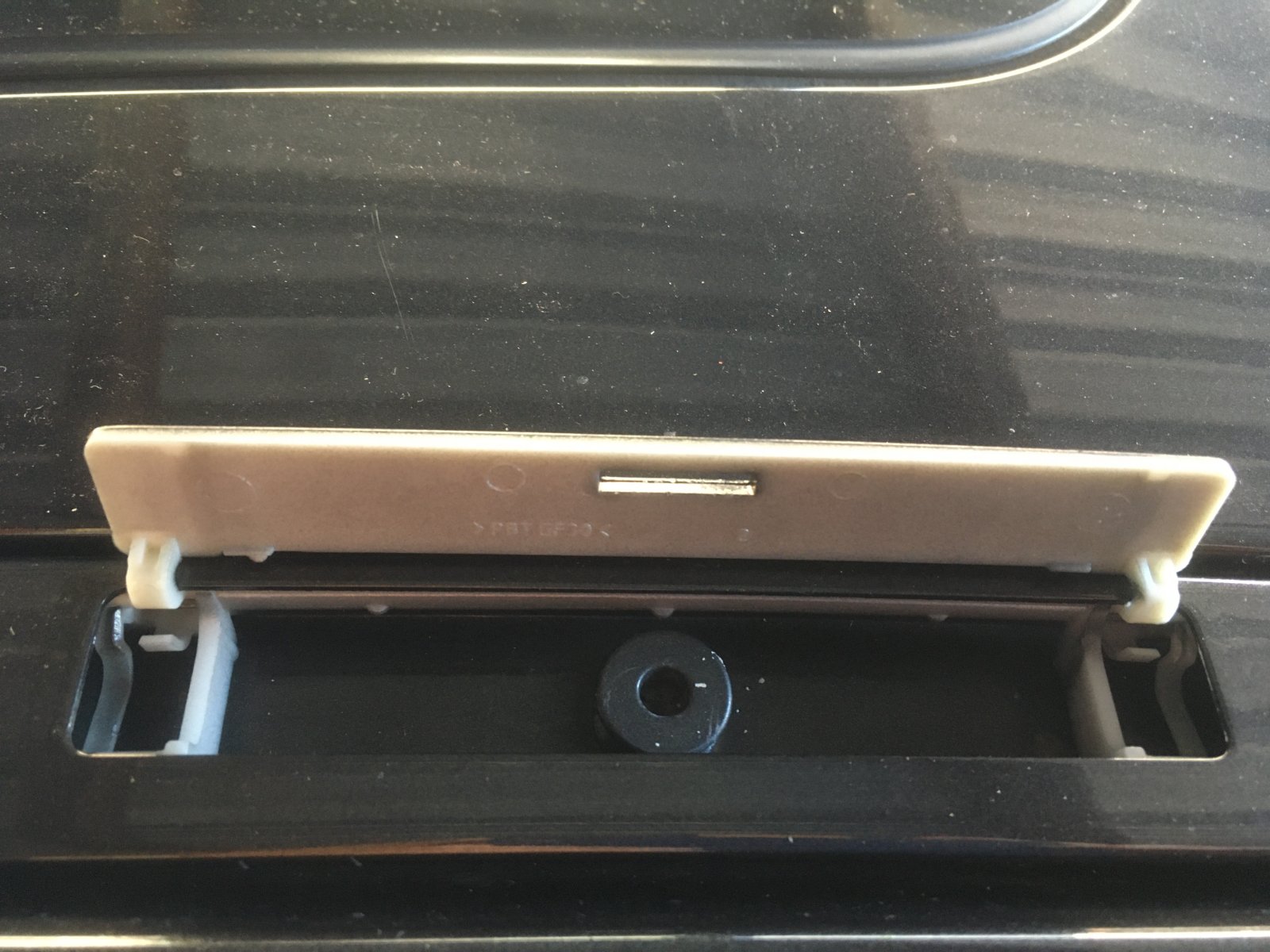

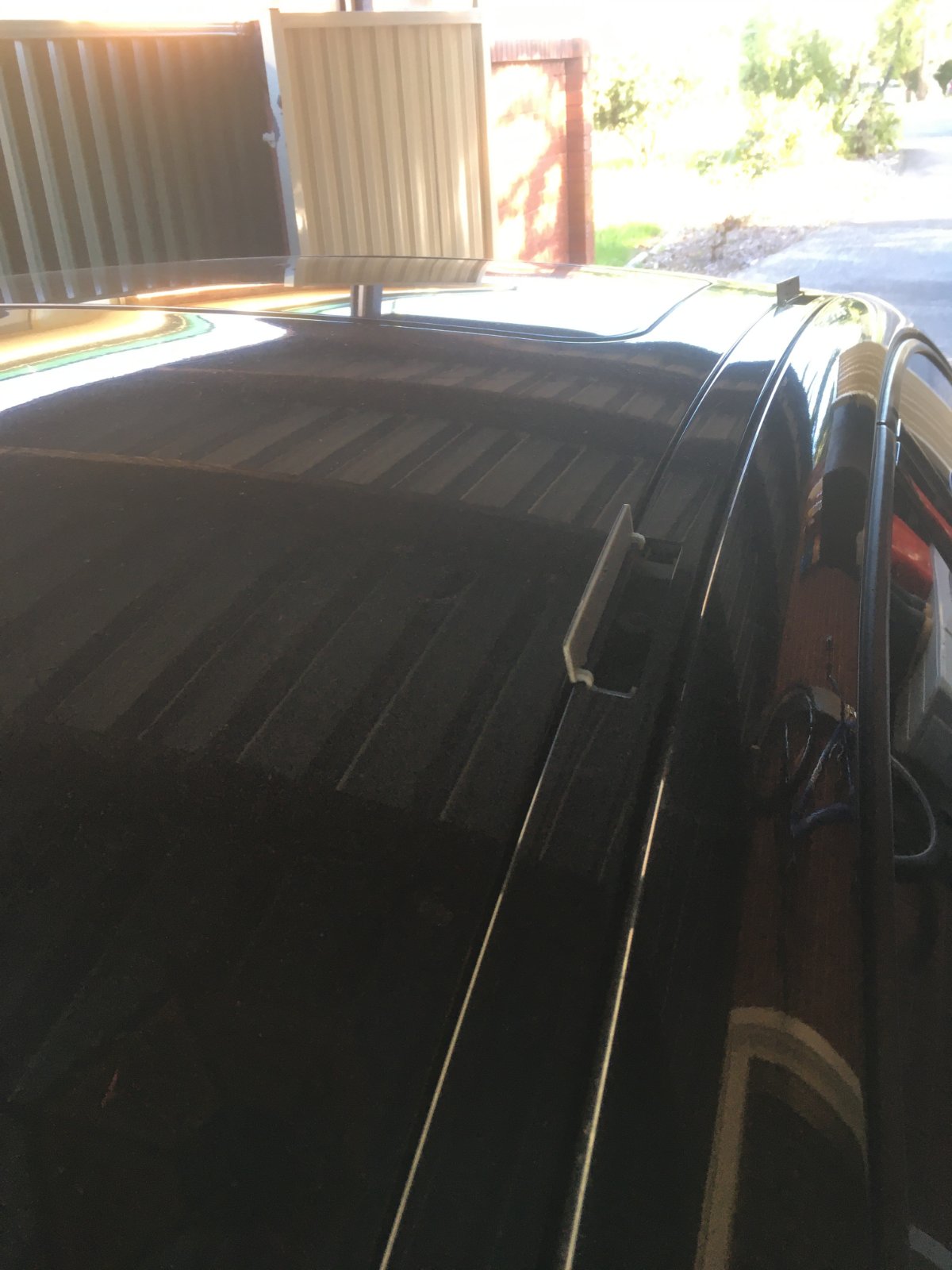

Re: C5 X7 Tourer roof bar location on rails
I have a pair of Citroen roof bars which quickly clip to the roof rails. If you look along the inside faces of the roof rails there are four pairs of indents. Presumable these mark the suggested places for the bars to be fitted. I find they fit there the easiest, but then I move them wider apart since I usually carry ladders.

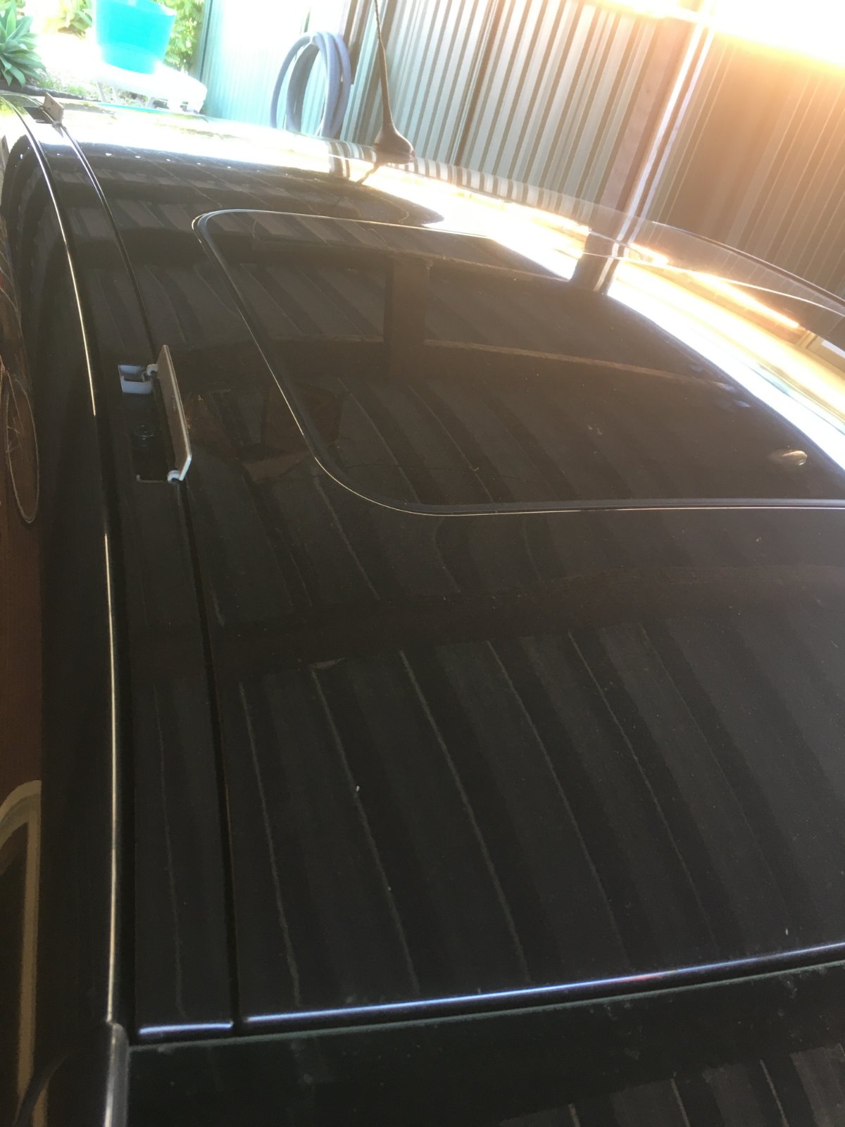

Does anyone recognise this original PSA part number of this roof rack? 16 715 530 80 and will this fit the C5X7 sedan 2014 series.
If not, what roof bar/rack will fit the Citroën C5X7 2014 Sedan HDi 2.2L.
The width from (passenger to driver's side) is 104 cm wide. Curved roof.
The fitting system is a "Fixpoint as per picture.
- x 6955
No, that's not a recognised part for the X7.
If you want official accessory part numbers, pop up the VIN for this vehicle along with:-
What it is you want:
Horizontal roof bars, bike carrier, luggage box etc.
You'll need to upgrade your membership though, as we have to pay for parts data, but it will cover you for up to 2 years of parts requests and parts diagrams. Details below:
Or have a look at the range from Thule, as Citroen often use some of these models. I am having an issue finding any roof bars alone which are recommended for the X7 Saloon.
Or take a look at the Citroen European Accessories site here:
https://citroen-shop.eu/gb/310-c5-x7
