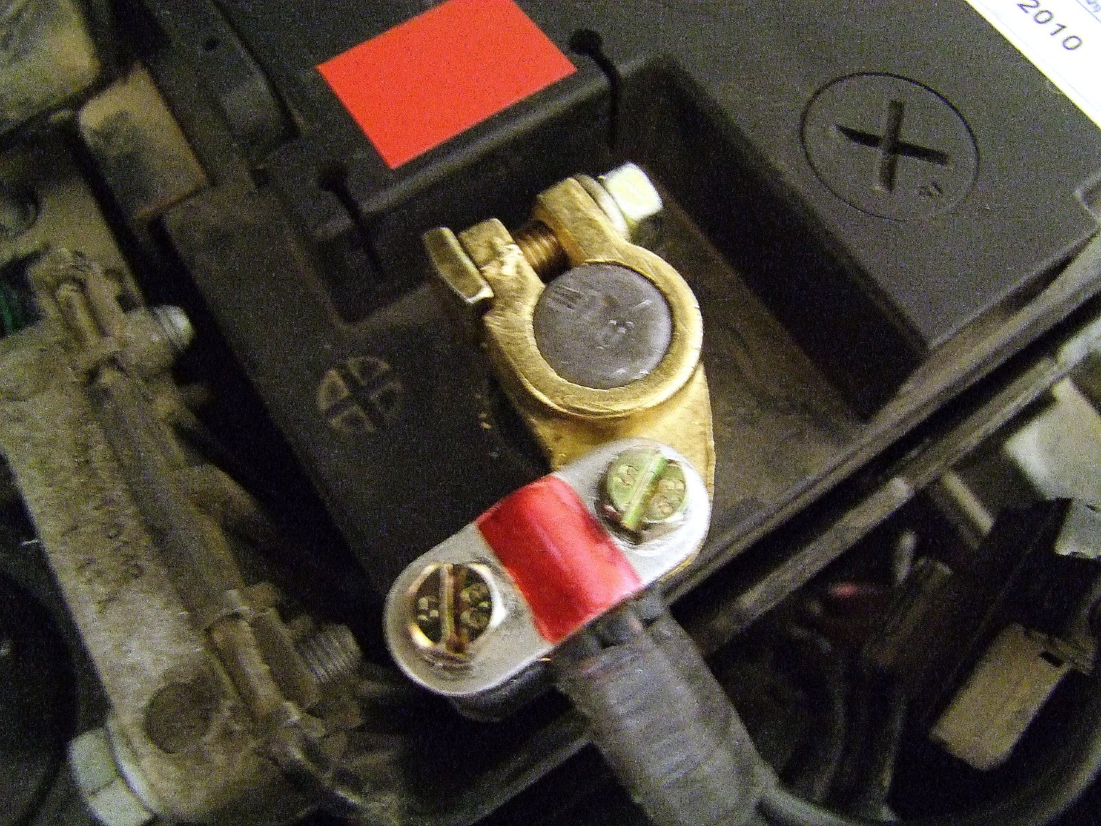

It's probably a good idea to replace ANY of the original lead (Pb) lump battery connectors on our cars from 10 or more years ago.
As the earlier thread viewtopic.php?f=3&t=38273#p317742 details, the crimped-on connectors lose their grip over time, and also allow corrosion/oxidation of the multi-strand copper batter cables.
The poor connection that results
- prevents proper pre-heating (glowplugs) and cranking
- can prevent proper functioning of battery chargers, if clipped on to the lead connectors
- causes voltage drops to the car's systems, particularly on starting/pre-heating
- can cause the alternator to mis-read the battery's voltage, and prevent good charging from the alternator.
Resistance at the connectors may well allow small currents to be drawn (eg Batt/IGN light etc, on first click of the key), but will not allow higher current items (pre-heaters, windows, door locks, main lights) to operate properly.
These old connectors are best replaced with new brass ones, and cables cut back slightly (if length allows) and the strands cleaned up back to bright copper. (See web tips for cleaning up oxidised cable strands.)

I just did this job , massive improvement in starter speed !
