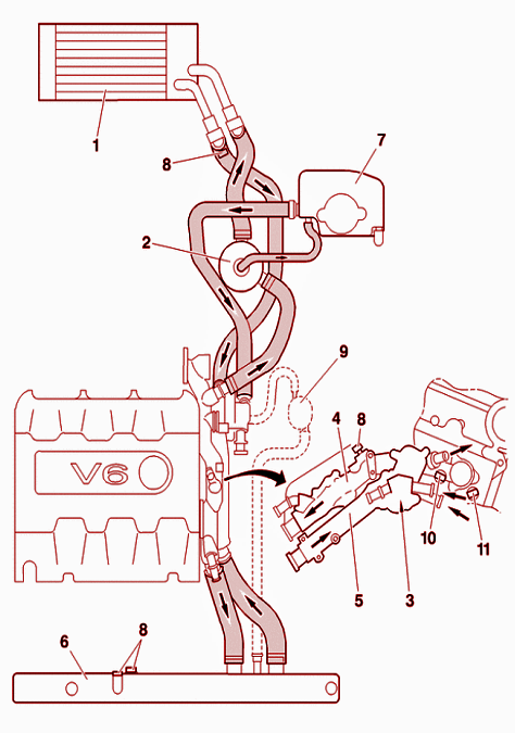

Anyway, some other info on the V6 cooling system in case you need it:
Click to Zoom Diagram Key
(1) heater matrix.
(2) Bubble trap.
(3) thermostat.
(4) Coolant outlet housing .
(5) Coolant inlet housing.
(6) Engine cooling radiator .
(7) Header tank.
(8) bleed screw(s) .
(9) Oil / water heat exchanger (automatic gearbox).
(10) Temperature sensor .
(11) temperature switch.

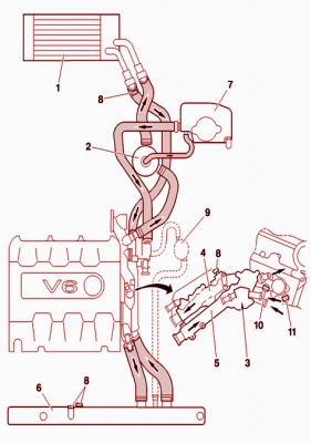

(1) heater matrix.
(2) Bubble trap.
(3) thermostat.
(7) Header tank.
| Data | |
| Designation | Values |
| Total capacity of circuit | 14 litres |
| Radiator surface area | 27 dm2 |
| Pressurisation | 1,4 bar |
| Opening of thermostatic regulator | 78 °C |
| Fan | |
| Number x Electric power | 1 x 500 W |
| 1st gear | FRIC function |
| 2nd speed | 105 °C |
| Warning | 118 °C |
| Post-cooling | 6 minutes |
| Reference | 10 | 11 |
| sensor | Temperature sensor | temperature switch |
| Information | Coolant temperature: Warning | Coolant temperature: Gauge |
| Connector colour | Brown | Blue |
| Tightening torque | 1,7 ± 0,4 daNm | 1,7 ± 0,4 daNm |

And....pay very careful attention to the refill procedure, there is a bleed screw on the water flow manifold (outlets on the side of the engine....8) and one leading to the heater matrix (also 8) ...this is "LIKE" a tyre valve...it is NOT the same and has a seal inside as well as being deeper. (easy to drop as well) I have replaced mine with a metal truck valve cap that is fitted with a seal.
