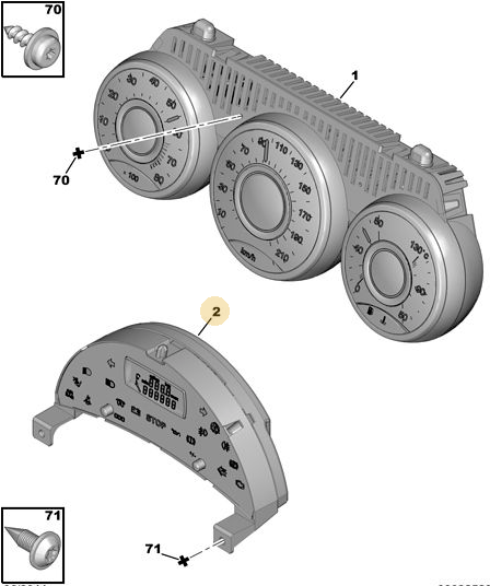

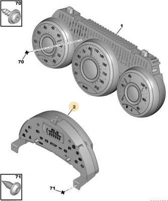

To be honest not really. The models with the 7" screen in the middle of the instrument cluster are fitted with an RT3 Head Unit (which includes Sat Nav / Telematics.). The standard option instrument panel has 3 round clusters of instruments.
This is the Multifunction Display supplied with the Telematics optionThis is the Normal Display type.
Issues you will have:
The electrical architecture may be different
You will need to buy a complete RT3 telematics system (of which the multifunction screen is part of) - but these are rare to find now.
You will need a new Instrument panel and suitable wiring harnesses, GPS Aerial and wiring.
It will need programming to the vehicle and configuring in the car's BSI.
Probably some other things that I can't quite remember now.
Probably a lot of expense if you can find the correct parts....
