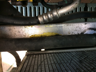

Think I’ve found the problem. The bottom hose appears to have given up.
It looks like wear and tear compounded by the overcharging of the gas.
You can see the fluorescent oil on the cross member just underneath the leaking pipe.
I suppose I should be thanking my lucky starts it wasn’t the condenser or pipe work behind the dash.
Thanks.

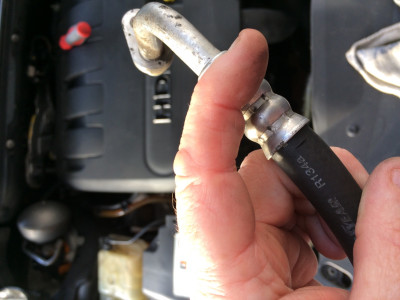

Incidentally, the hose I have, part number VP8X7H-19972-BA seems to be listed for the Peugeot 407 or C5 1.6hdi.
The hose listed by a supplier on eBay has a 360° loop on the compressor end.
Vin = VF7**************[VIN obfuscated, can be read by forum staff].
Re: Air con again!!
P.S.
The hose from my C5 does not have a 360° loop on the compressor end, just a 90° bend.

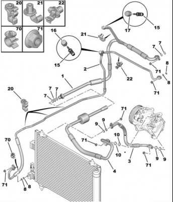

Ok, so can you let me know which o-rings you need from which diagram then I can advise of part numbers.
Just refer to Table A or B and tell me the item number.
Table A | Table B |
Re: Air con again!!
O rings are number 9 on diagram A. The hose is number 3.

Ok, give me a second...
So the O-rings are part 6460V0 and are £1.03 inc. VAT each
The Hose is part number 9677930480 and is £78.67inc. VAT
Note these are all zeros not letter ‘O’s
All available to order from Citroen.

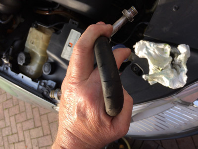

The a/c gave out on me on my day out to Tenby and Saundersfoot today. I cooked.
At £78 inc VAT I think I may be ordering from EBay. There’s a company in Nottingham supposedly selling genuine hoses for £29.
Interestingly the original hose has a sticker on it with the part No 9659577880
Thanks again.
Thanks again.
