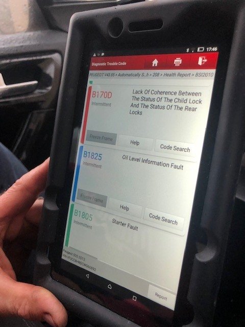

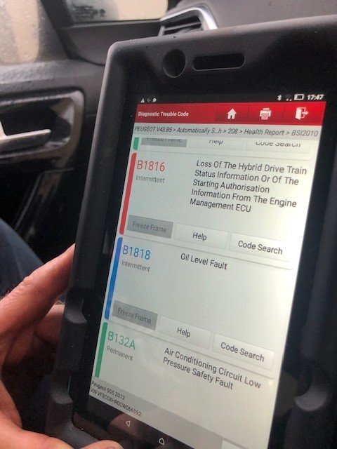

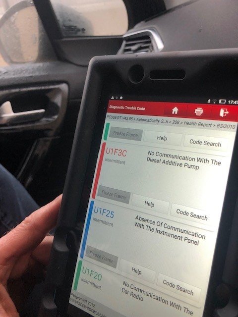

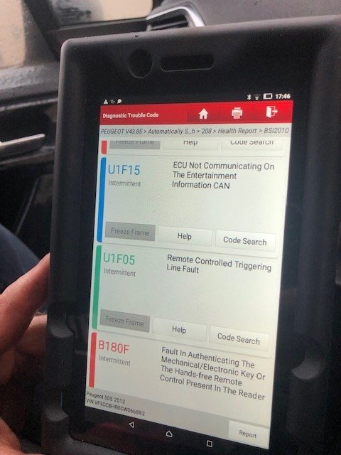

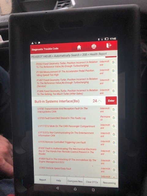

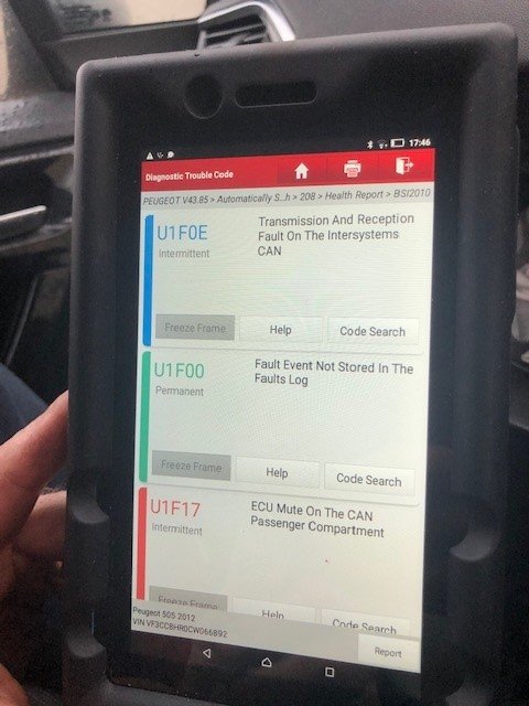

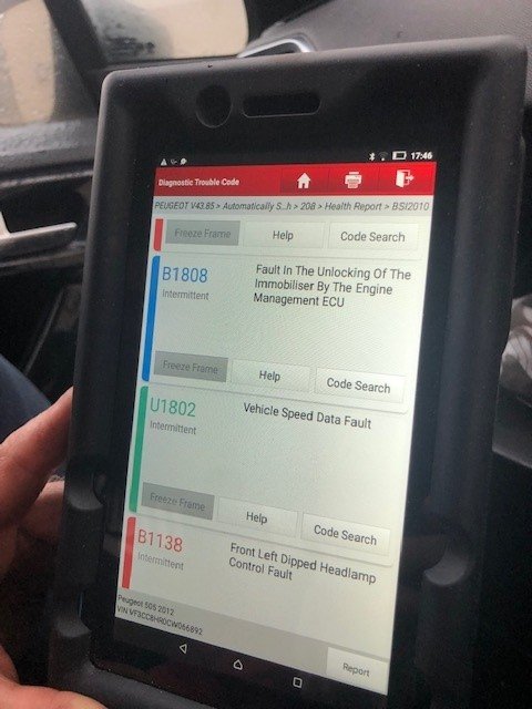

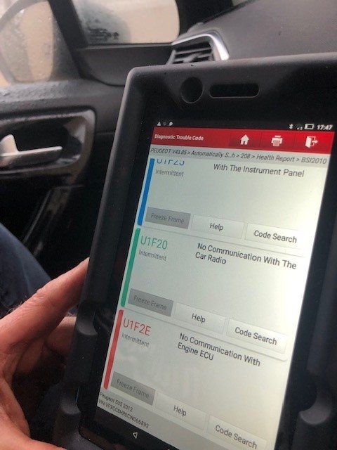

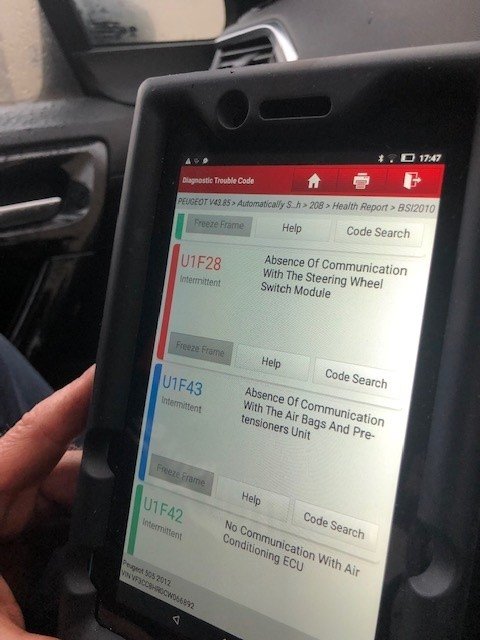

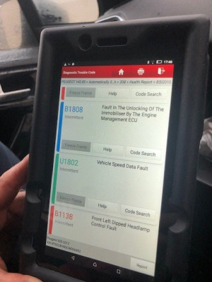

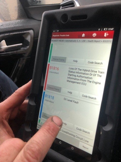

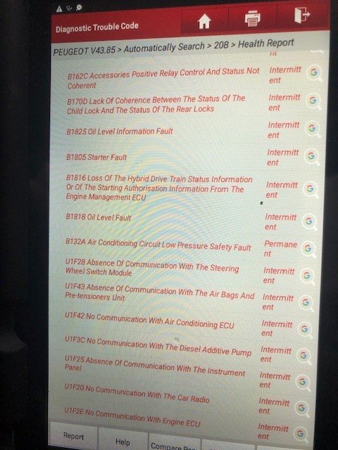

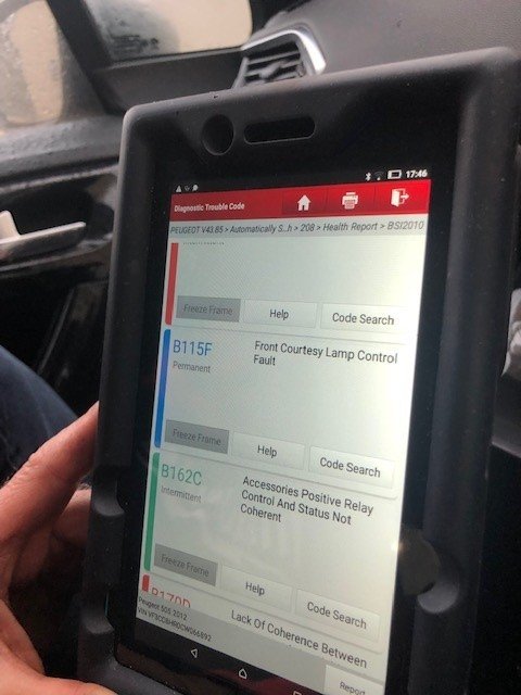

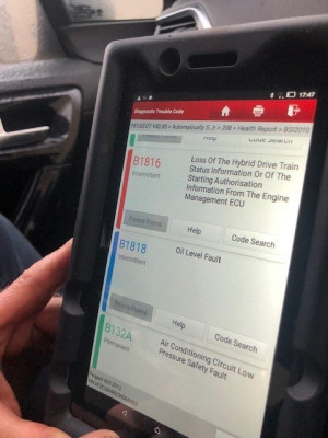

Hi all!
I see there hasn't been much activity on this forum in a couple of years.
I am wondering if someone could help me out with the faults that have appeared on a Peugeot 208 that I have.
A lot of these faults seem relate to the ECU - I have posted the photos below of the relevant fault codes.
I am a bit of a car novice but can anyone advise if these are worth fixing or even on the cost / time to fix?
Thanks a mill!!

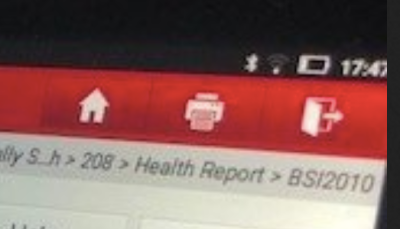

Ross_K
- Posts: 1055
- Joined: 18 Jul 2004, 22:26
- x 110
Re: ECU Problem maybe

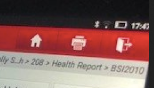

That's a lot of codes
See the printer icon on the tablet screen? If you click that you can save the report as a text file and upload it here. It's a bit easier on the eyes that way
OnlineRichardW
- Posts: 12566
- x 1485
Most are showing intermittent, and that is the sort of blizzard you get when the battery is low. What's actually up with it? I would clear all those out and then see what comes back.
