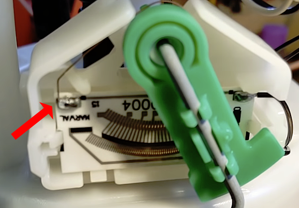

On the sender units, there is a thin wire that can become detached from the sender unit that sends the readings to pot. If you have Diagbox diagnostics with a Lexia 3, you can perform a test on the gauge to check the Ohms and compare it with what the instrument panel readout says.

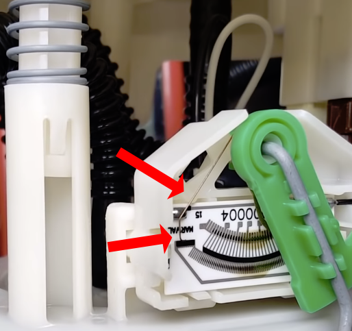

The brimming is just another possibility - as this actually happened to me and has happened to others. The dealer recalibrated it and all was back to normal - I used to literally brim it to the neck - but have not done so since.
Having said that, I don't believe this is your issue, as it is not just a matter of having it stuck in the 8/10 position - yours seems to be vastly out of range, which is why I suspected the sender gauge wire on the unit may have become dislodged.
| The wire arrowed in red has come away causing erratic readings when the float lever is moved up and down. | Here the wire has been soldered back in place |

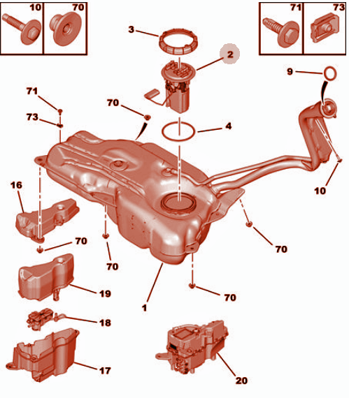

Thanks for the reply guys, any idea how to get access to the sensor ? My understanding is it's under the back seat, if so any idea how so you remove the back seat ? Cheers

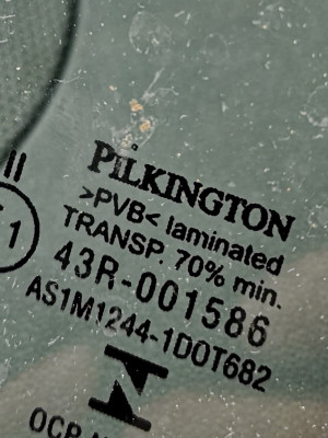

Pop your VIN up here and I'll see what I have as there are a few different types.
Lees150815
- Posts: 5
- Joined: 22 May 2019, 12:03
- Posts: 9321
- x 1939
Re: DS3 fuel gauge issue
No that's just information about the windscreen itself.
The VIN is visible through a small window situated around the edge of the windscreen near a LH or RH lower corner.

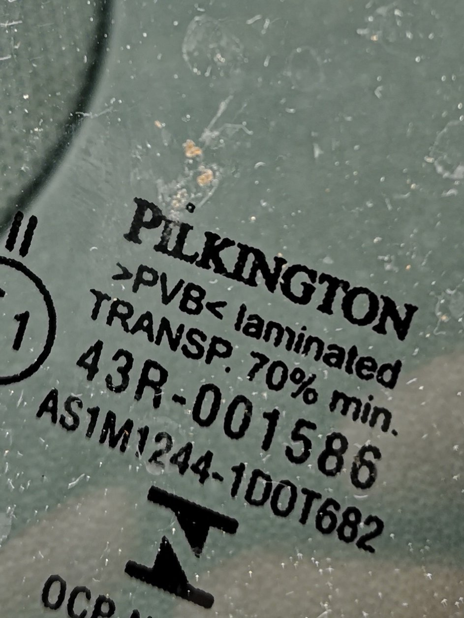

Lees150815
- Posts: 5
Here it is. Excuse the hands in the picture lol cheers
Admin Edit:
Admin Edit:
Ok, we have it. I have removed the picture for you protection and replaced it with the VIN here that staff can see.
Reason: Removed VIN picture

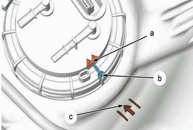

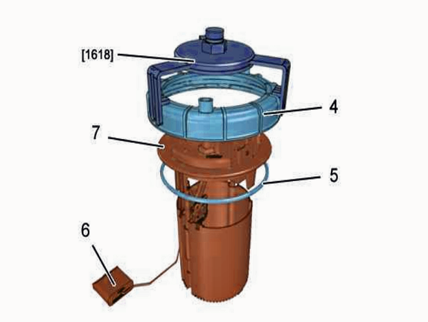

Ok, so you have the sender gauge unit without pump.
You'll need a suitable tool to remove the fixing ring:
Removal
Disconnect the battery.
Remove the rear seat.
Refitting
CAUTION: Always replace the seal (5).
CAUTION: Take care not to damage the seal (5) and the float arm (6).
Unscrew: The ring/nut (4).
Refit:
The new seal (5)
The fuel gauge (7); Take care not to damage or distort the float arm (6)

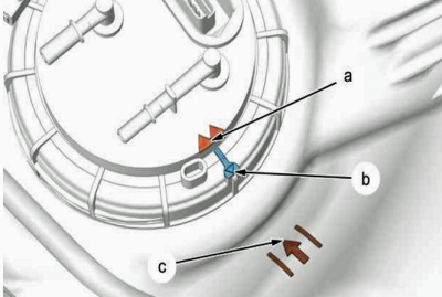

N.B. : Align the arrow "b" on the ring nut (4) with the reference on the fuel pump and gauge assembly "a" as well as with the reference "c" on the fuel tank.
Reconnect the battery.
Check the operation of the fuel gauge on the instrument panel.
Checking for leaks

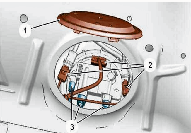

Removal
| Remove the blanking piece (1). CAUTION: Before uncoupling them, clean the click-on connectors (If necessary). CAUTION: Plug the click-fit unions (3) (according to equipment)
| ]CAUTION: On removal, protect the fuel gauge well surround with absorbent paper; Place a tray under the fuel gauge well immediately. CAUTION: Following removal of the fuel pump and gauge assembly : Immediately screw the ring nut (4) back on the tank to avoid any distortion of the fuel gauge well (Risk of fuel leak). Remove:
Refit:
The new seal (5)
- Refit the ring-nut (4) and tighten with tool [1618], until the arrow "b" is aligned with mark "c" and mark "a".
- Reconnect the connectors (2) (according to equipment).
- Couple the click-fit unions (3) (according to equipment).
- Operate the manual priming pump for 120 seconds to prime the fuel circuit.
Checking for leaks
