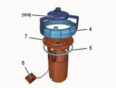

Ok, so you have the sender gauge unit without pump.
You'll need a suitable tool to remove the fixing ring:
Removal
Disconnect the battery.
Remove the rear seat.
Refitting
CAUTION: Always replace the seal (5).
CAUTION: Take care not to damage the seal (5) and the float arm (6).
Unscrew: The ring/nut (4).
Refit:
The new seal (5)
The fuel gauge (7); Take care not to damage or distort the float arm (6)
N.B. : Align the arrow "b" on the ring nut (4) with the reference on the fuel pump and gauge assembly "a" as well as with the reference "c" on the fuel tank.
Reconnect the battery.
Check the operation of the fuel gauge on the instrument panel.
Checking for leaks

| Remove the blanking piece (1). CAUTION: Before uncoupling them, clean the click-on connectors (If necessary). CAUTION: Plug the click-fit unions (3) (according to equipment)
| ]CAUTION: On removal, protect the fuel gauge well surround with absorbent paper; Place a tray under the fuel gauge well immediately. CAUTION: Following removal of the fuel pump and gauge assembly : Immediately screw the ring nut (4) back on the tank to avoid any distortion of the fuel gauge well (Risk of fuel leak). Remove:
Refit:
The new seal (5)
- Refit the ring-nut (4) and tighten with tool [1618], until the arrow "b" is aligned with mark "c" and mark "a".
