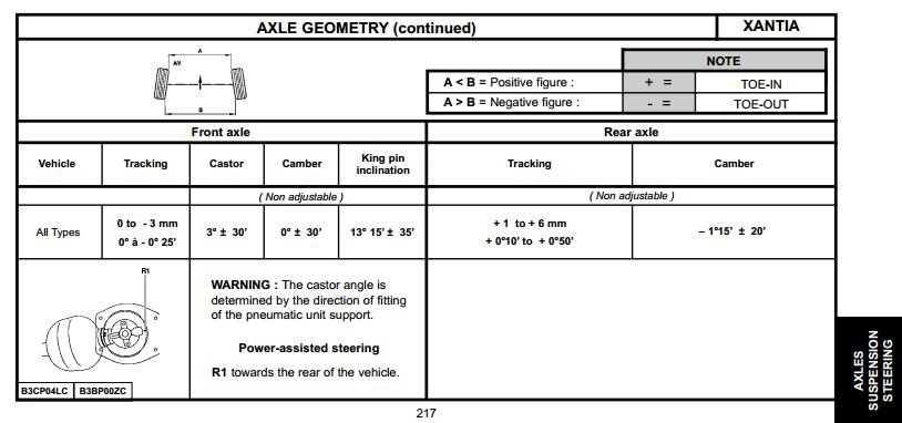

Xantia steering geometry (running height, tracking, etc) data here:
viewtopic.php?f=3&t=61218#p590278
"Private Car books, 2001 - Xantia, XM, Synergie"
pp215–217
pp215–217

Re: Wheel tracking "computer says no"
That agrees with the info that I have, but for completeness, cars manufactured before the 1996 model year had the king pin inclination specified as 13° 20? ± 30? and cars without power steering before the 1996 model year had castor angle of of 1° ±30?
