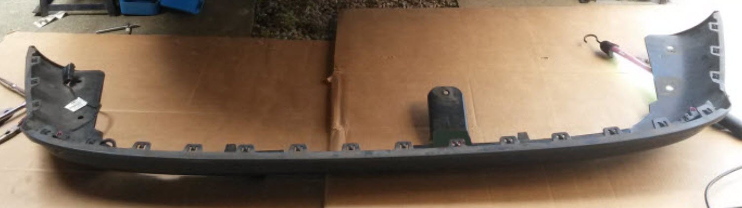

I know you have basically decided not to do this, however, I fitted OEM front sensors to my 2011 and basically all the main wiring it there so I only had to buy the actual front harness (the one that goes along the bumper) so I would imagine the same would be for the back. However, you will need the rear ECU, I bought mine from a scrappy for less that £30, I dare say the rear harness, as it is a common 'extra' sold at time of original purchase could be sourced the same way.
Ebay/Amazon (any any other online supplier) can supply the sensors & the mounting plates for the rear bumper, or just try to find the lower skirt in the scrappy, they are all black!!...unless you they are already there and just not pushed through.
Once fitted, you will have to 'tell' the car they are there, radio & center screen/Display? and the rear ECU will need to be triggered..........fairly simple with a Diagbox/Lexia.
Failing that there you can fit a stand alone cheapy parking sensor kit connected to your reversing lights, there are two types out there, Holes & No holes separate display no display, I have fitted both types to various cars, I actually fitted the type that does not require holes to a C4 coupe as I did not want to damage the paintwork and it worked well!
ECU's part number is VERY important and is printed on a label on the outside of the unit and sits in a rack above the left hand rear wheel.
Good luck
Lower Skirt, easily unclips.
