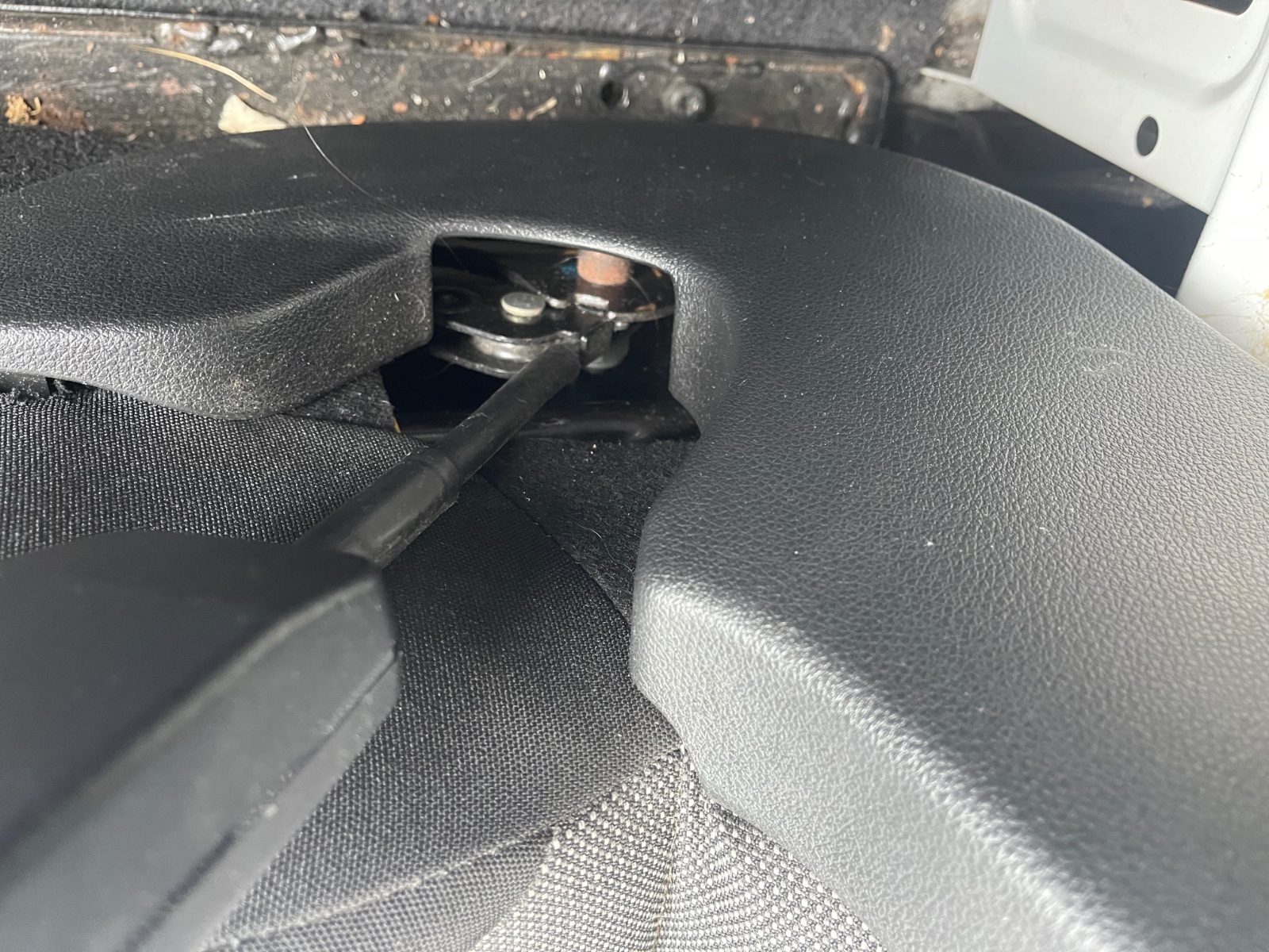

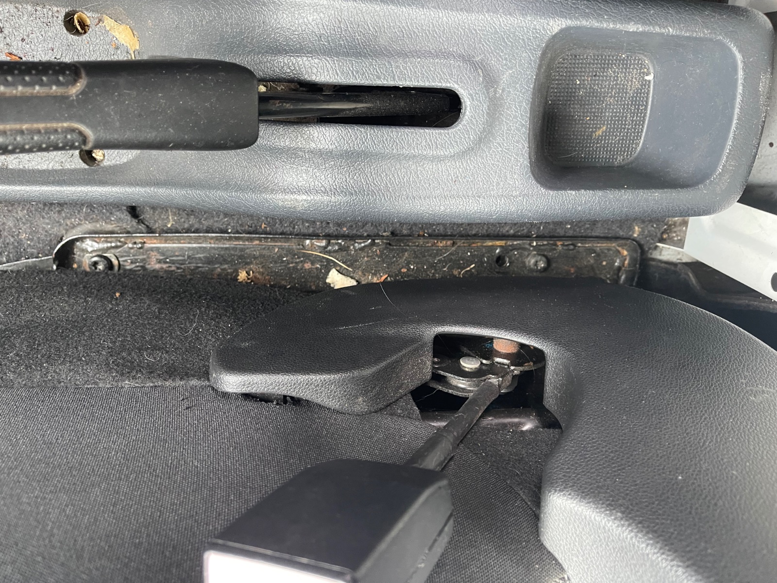

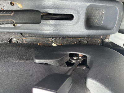

Anyway, looking at these new seats, there’s only drivers seat that has wire to seatbelt clip.
Also, there’s no pretensioners fitted unless they’re on the belt end.
So, do I need them ? Insurance might be bit touchy if I haven got them ?

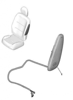

Your likely trying to mix seats designed with side airbags. The pretensioners are fitted into the anchored portion of the seat belts if fitted. There are 2 types with and without pretensioners.
As for the seat - if you have the outer section with this panel and a small label - then it has a seat airbag.
Basically if you are modding any part of your car - but especially anything that concerns safety devices you really do need to let insurance know or you are effectively asking for trouble.
Obviously you can't connect a seat with airbag to a vehicle without the system - but be aware that you still have the explosives inside the seat, so don't be connecting the wires anywhere soon.

No airbags fitted. As it’s a campervan I may not have some of the issues with insurance that may affect more standard vehicles. It’s quite common for owners to swap seats and fit something more comfortable.
I will inform the insurance and will consider fitting either the other part of the belt to match the seat, or fit the pretensioners from the old seats to the new seats. I’m just confused as to why there’s no connection to seatbelt on passenger side ?

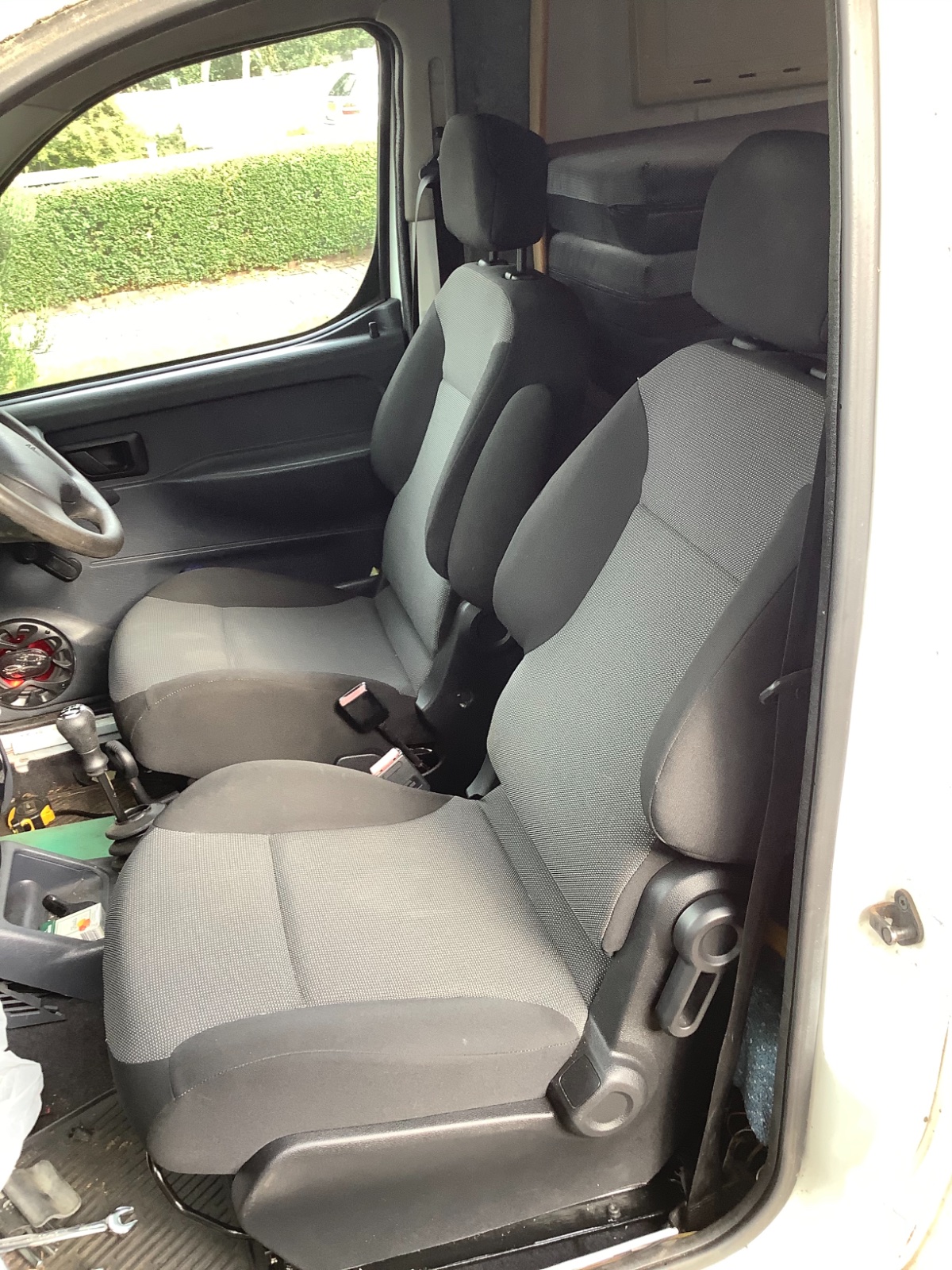

It’s been a while, but I’ve really got to get these seats sorted. After lots of design changes I finally settled on the best way to fit the 2016 seats to the 2001 van. Major issue was trying to keep the flip up option. After numerous attempts I realised it was a no go, so a more simple design where they’re just welded to new mounting plates bolted onto the original chassis points. A major problem I encountered was the angle of the seats bases. But I’ve made the new brackets to take this into account. Still stuck on the seat belts though. There are 3 options I can see. 1. Weld some plates onto the new brackets to bolt them onto. 2. Bolt them to the new seats where the newer unit fits (I’ve tried this and they do fit but will need a small bracket welding to the seat frame to secure) or 3. Try and fit the belts from a 2016 model Bingo. That would be my preferred option. So anyone know if the newer seat belts will fit, and if not can I modify them or the van to make them fit ?

I meant to post picture of the new seats but seems an age ago I did it. Anyway, Insurance Company didn’t charge me any extra for the new seats and the original pre tensioner fitted the new seats, only in different place and on opposite sides.

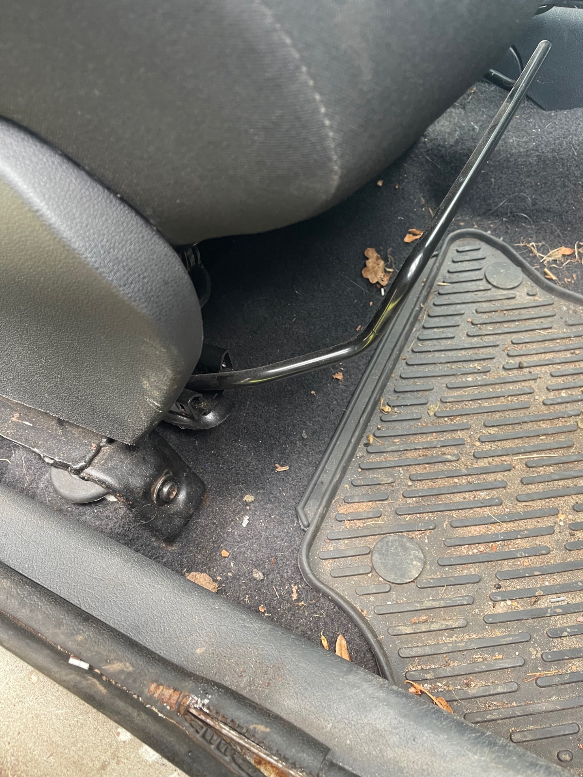

You are right about width issues and the newer seats are also longer too. The newer seats have a separate frame which bolts underneath the runners. I actually used part of this welded to part of the older seat frame on one side, and some 50mm steel angle on the other. There’s also an issue of the angle at which the seats fit and how far forwards you fit them onto the base. It was a game of trial and error until I was eventually satisfied I’d got the best compromise.
The seat belt tensioners were bolted onto where the originals were but if I remember right, I had to swop them over. ie. Os to ns. There are pros n cons to this conversion. The cons being I can no longer easily access behind the seats, and I can’t climb over them to get into the rear. They do fold forwards nicely though to give the extra foot room needed when I’m in bed. Remember though, modifying the seats could compromise your safety in the event of a crash. Any modification needs to be to a suitable standard. .

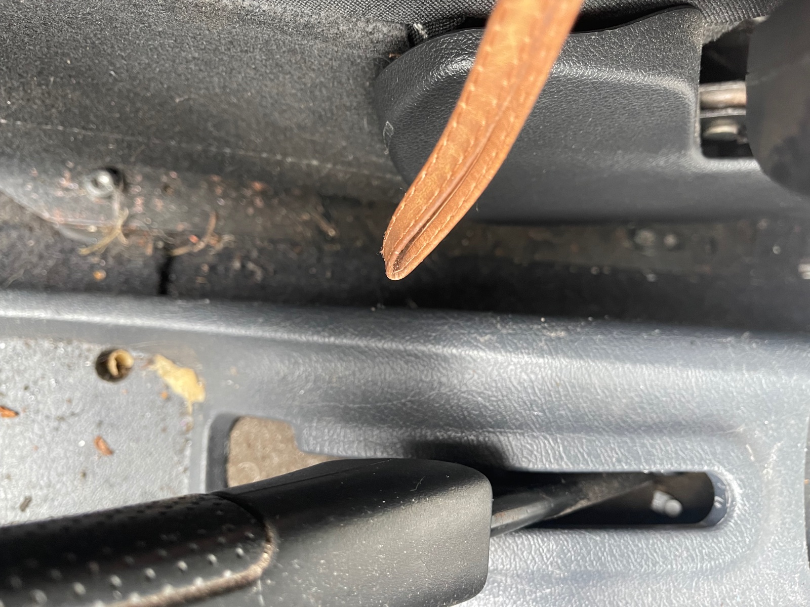

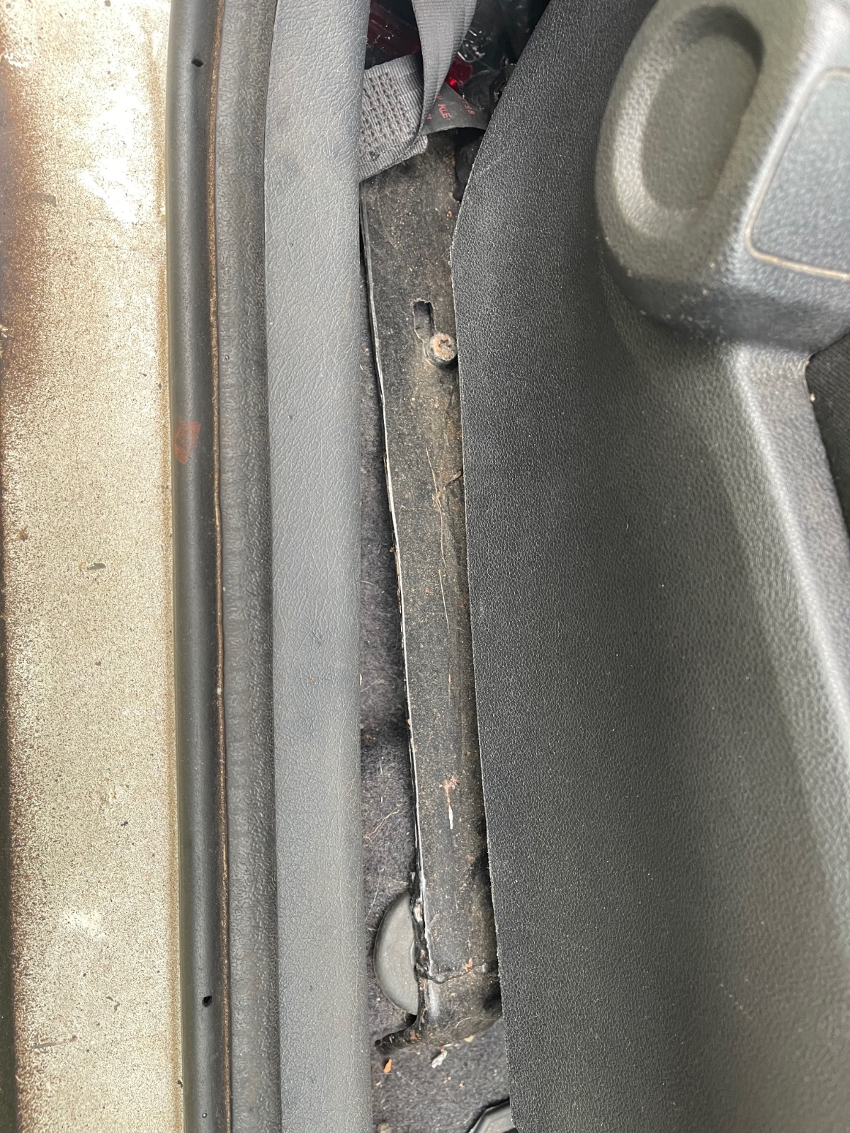

Hers some pictures. I use parts from original seat bases and parts from new seat subframes. The difficult mount to make is the one at the front that bolts through horizontally, I just cut that part from old seats and welded it on.
I got a little sidetracked at start of build as I was trying to make passenger seat fold flat and flip up like the old seat did. But after numerous failed attempts I resorted to simplifying the build.

Excellent job, thanks for the picts! After reviewing your method I decided not to walk the extra mile. As I don't have a welding device within reach, too many hurdles to get it done this way. For now searching other options, I read somewere online cushions can be replaced with Citroen XM ones. Although I doubt it, let's dive into this option. Or search for good better originals. Mine is a 2015 van, 273 k so not willing to invest too much pesos into it. Thanks for sharing!
