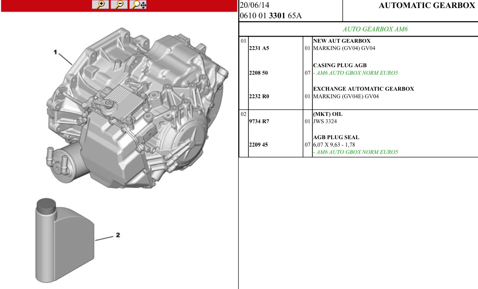

I am about to change the auto box oil in my C5 X7 3.0 HDi from 2013. Based on service.citroen.com is the proper oil AW-1 (i.e. JWS 3324). I read here in the forum that for the EURO-4 engines the oil was JWS 3309 and for the EURO-5 the mentioned JWS 3324. Althought this was apparently for the same gearbox.
So what has the Euro-norm to do with the gearbox oil? The newer oil has lower viscosity. Could that be, that the lower-viscosity oil was used to achieve the EURO-5 norm only? In other words, is the oil for the EURO-4 engines even better for the auto box itself?
Why am I asking is, that I bought the oil for the EURO-4 engines but should use the other one. Can I still use the JWS 3309? Is it better for the auto box, or should I buy the JWS 3324?

Ok, so you have the AM6-2 automatic gearbox, which is rated Euro 5 Karel, so correct, you need JWS 3324. There are different variations of the AM6 - no doubt in part to meet improved Euro standards, so require different oils.

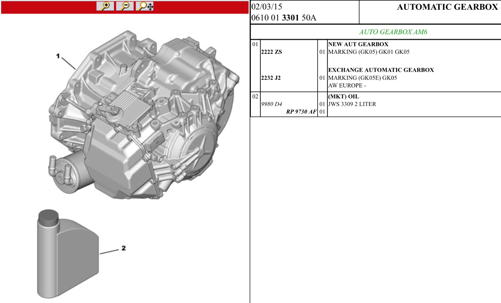

EURO 4 engine: JWS 3309 ESSO oil
EDC5 has a Euro 4 version and you have a Euro 5 AM6-2 according to your specifications.

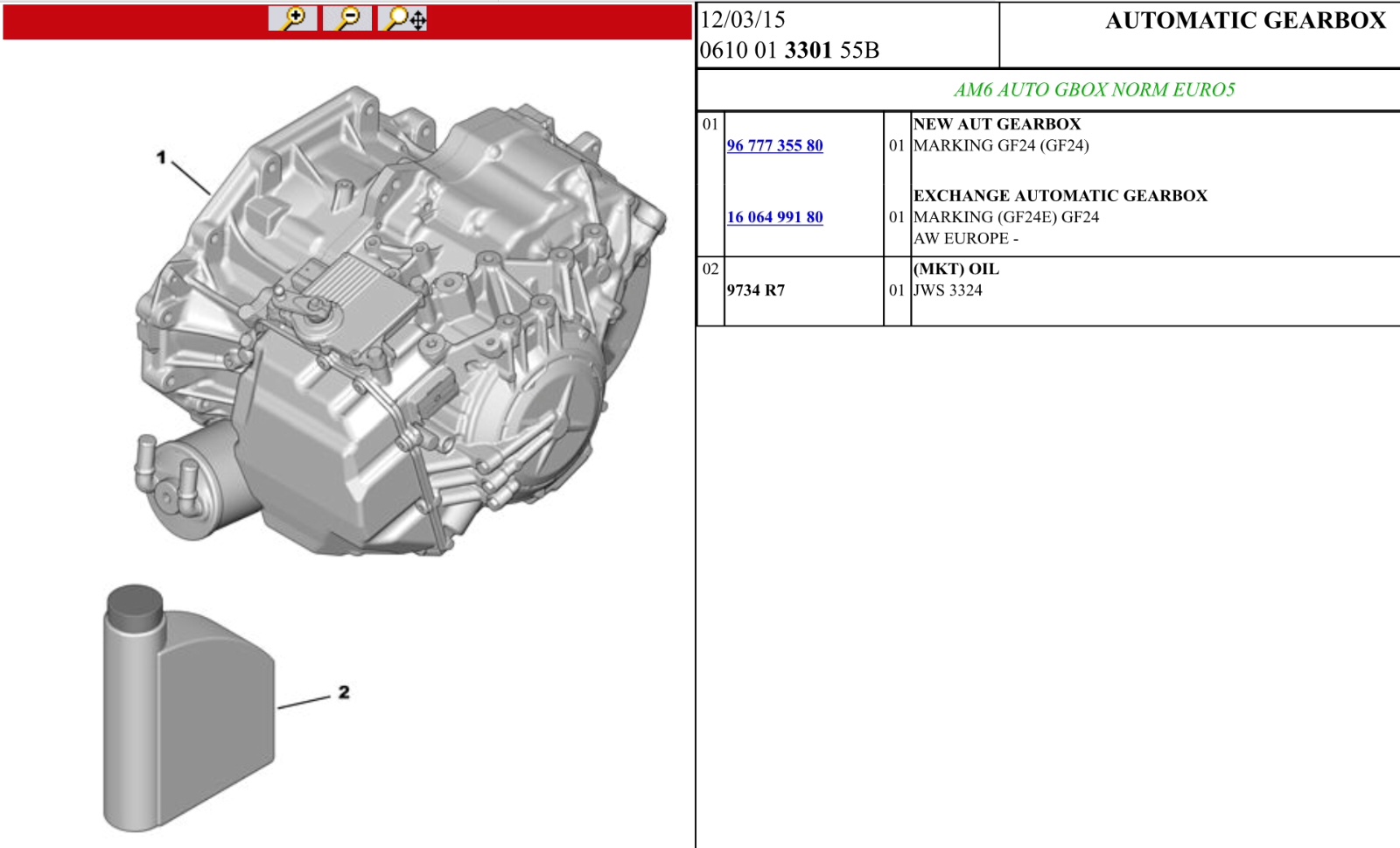

EURO 5 engine: AW-1 oilCAUTION: The oil type "AW-1" in AT6 and AM6 gearboxes with engine version Euro 5 is specific and cannot be replaced with oil type ""JWS 3309"".

2222ZS for the AM6 (GK01, GK05)for the DW10BTED4 ... and again DW10BTED4 Euro 6:
DW10CTED4:
And another different box for the 3.0 And there are more, with different markings depending on engine and build date.
DW10CTED4:

No, there are other differences! The hydraulic blocks have different part numbers and so are the electronic ECUs all different between the various Euro standards and AM6 boxes fitted to different engine versions.
It’s not just a matter of oil or why would they make so many variations of the gearbox, the electronics, the hydraulic blocks and other components. I think we can all speculate, but the fact is, the component parts are different for the different versions of the AM6.
What is important is that the correct standards are met for the specific gearbox. Your choice of course, but you asked about the correct oil for your box and you have the answer.

There are no clear statements that the gearbox for Euro4 and Euro5 are identical. They have different part numbers in service.citroen.com. So my impression is that the Euro5 boxes may be slightly different eg. the insides of the hydraulic block (different clearances, gaskets etc.) and therefore might require the thinner oil. But there is no clear evidence for that. (different part numbers is not a clear evidence for me).
Based on the oil specifications I came across, the JWS3324 oil is very probably downward compatible with the Euro 4 auto boxes (EDC5 is using it as well), but the JWS3309 (Euro4) oil is not upward compatible with the JS3324 - but maybe only while in the time of writing the specifications of JWS3309 there was no JWS3324 oil. Nevertheless, EDC5 came across the information from AISIN stating the two oils ARE interchangeable.
Under that circumstances I think I'll keep my 4 litre can of JWS3309 oil aside and use only the newly ordered 7 litres of JWS3324
