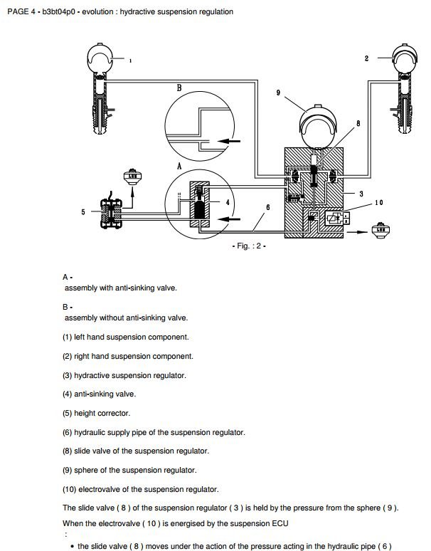

The regulators are not that complicated inside: essentially a shuttle valve, moved one way (firm) and the other (soft) by hydraulic pressure from the sphere, and the system (via the Electrovalve), respectively. The EV is also a simple mechanism, but careful how you unscrew it on its fine (aluminium) thread.
A page from the HA Evolution (new-type regulators) document, showing original type valve innards:
Click to enlarge Most likely just the EV solenoid not operating properly; might just be dirt. Worth taking that out first.

I think that it is only the electrovalve that can leak, not the main hydraulic valve, and it is a lot easier to change only that.
I have only experienced electrovalve leaking when energised, Does yours leak when not energised?

Re: Xantia sinking front end
Leak can be detected by seeing what emerges from the low-pressure return pipe at the end of the EV.
Normally, very little emerges from this.
Diode failure could, I suppose, prevent the EV solenoid from working fully (i.e. proper pull-in). Easy enough to strap on an extra diode (band on diode to +ve) to test.
There's a small spring in the EV too, which is there to close it when de-energised. Could be weak, or need a gentle stretch.

Thanks chaps - all geat info. It leaks when the solenoid is energised and less so when it is closed but still when closed. You can see the main difference in the PRV cut in/out times comparing it with the EV open, closed, low suspension, normal and high. There's a marked difference but the PRV is cycling way too fast at best anyway (has a new accumulator sphere too). Getting 4 seconds on normal height, 8 seconds with EV closed and about 21 seconds with it on low.
