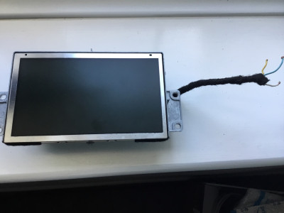

Hi all,
I’m looking for someone in the Dorset area ( Poole /Bournemouth) who can connect my LCD to my SatNav.
I’ve done the VIN and can sort all the rest of the install, just have no idea how to connect the brown cable ( that connected to the LCD) to the head unit to receive power, beyond my remit.
Any help or suggestions would be great,
Many thanks in advance .

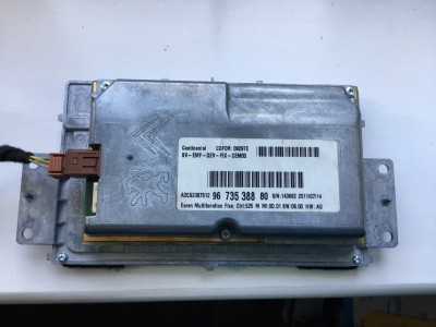

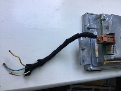

You are missing the specific LDV plug at the other end that has been chopped off. You'll need that for a start. The rest is pretty simple - what vehicle is this for? You haven't said in your profile.

As for the plug it is not sold separately. You've obviously got this one from a breakers who have unceremoniously cut the wires - incredibly stupid and inconsiderate, when it could simply be unplugged from the Head Unit.
The cable is sold separately, but I'll need your VIN to get the correct one as I need to identify the exact unit you have. I can then price the cable up and get a part number for you.

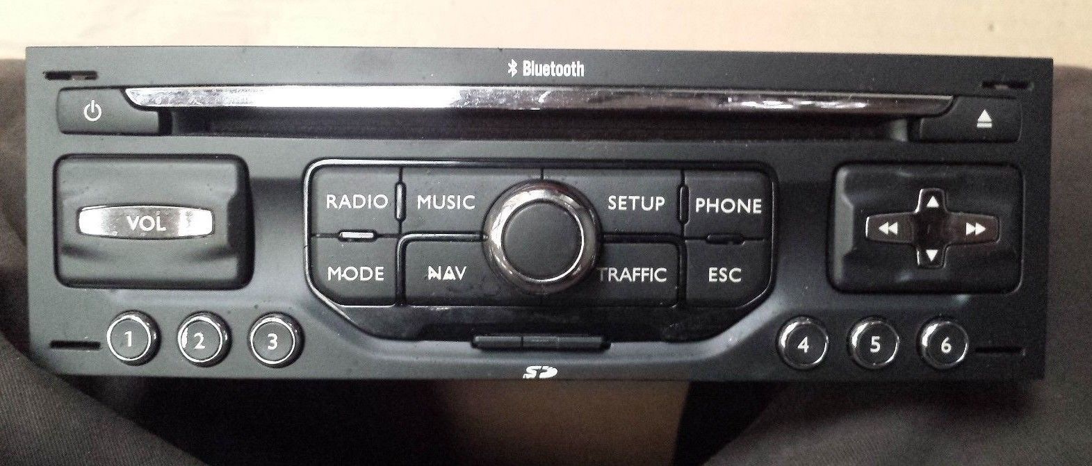

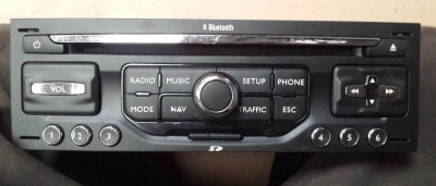

it still has to old unit in, as i can't get the LCD connected due to cable issue, i have this--> RNEG 96736746ZD BE6450 I'm pretty sure its the MyWay system
see attached pic.
Thanks
see attached pic.
Thanks
- x 6948
Re: Need LCD fitted to SatNav
Ok, so yes that is the RNEG MyWay by Harman Becker. So I can get you the cable you will need. But also, don't forget, you can't just plug this in and expect it to work.

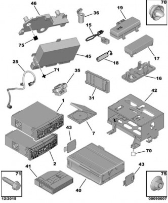

You need Citroen Part Number 659366. Citroen sell these at £42.95 inc. VAT.
Item number 25 on the diagram.
