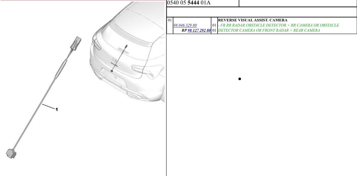

It’s quite possible there is water damage or interference. The camera is independently connected to a short cable that plugs into the main harness as you can see here/

Thank you for the quick reply. What would be the best way to access the main harness? There are 2 covers in the boot of the car on each side and there are cables being hidden inside. I know some of the connections are for the lights, but I am not sure if any of them are for the camera. Many thanks for all the help.

Pop your VIN up here and I’ll see if there is anything else I have on the wiring.
