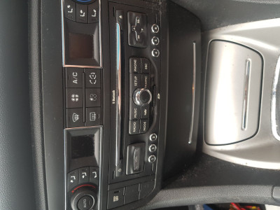

Hi guys as the subject really trying to figure out what type of unit I have in my 2009 vtr+nav.
As I'm looking to upgrade this so I can stream music from my phone without losing any off my current features I have been scrolling this forum for the fast knowledge available but still no wiser also I noticed a lot of it needs coding to the vin no. But there are a few on Ebay that say they can code before sending the unit so you just plug in and use.
This is my current unit. I do have an aux (mono/phono) in the glove box. But surprised theres no USB connection also.
Look forward to the replays guys thanks for reading

If you post up your VIN (which will, for security reasons, be obscured; but the Moderators can read it) a Moderator with the right access can see what you car had when she rolled out of the factory, including the exact radio system she had.

citroenc5mad wrote: 09 Apr 2019, 13:26
Easy way - get a bluetooth receiver and plug it into the AUX. You don't get control of playback but it also won't cost you an arm and a leg.
Upgrading that unit (which is an RNEG, the SD card slot is a giveaway) to a newer one will need both the head unit and display, and display surround. There is a massive thread on it here.
