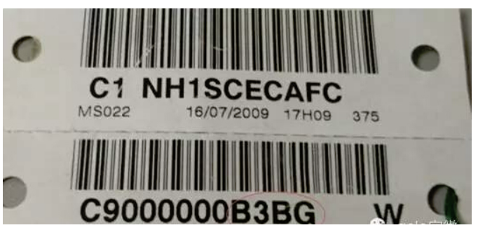

Then, among the pages of the handbook I found a piece of thin white plastic with two barcodes and what look like serial numbers separated by perforations - could these be what I'm looking for? I don't want to post a photo for obvious reasons but I'm hoping an X7 forum member will know what I'm trying to describe?

According to the handbook, something (I can't recall exact wording) that needed to be kept safe was also attached to the key(s). Do you have that, Marc?
The reason I'm asking is that below each of these barcodes is a very long alphanumeric. The top one perhaps being the unique key/doorlock/ignition code?
The second one below is just as long but begins with C and is then padded with "0"s until the very last four (ie C00000000000000000X6PV) of which just happens to be the security code format I've come to know.
Probably just coincidence, but ever hopeful thought I'd ask. :)

But is this the sort of thing you are referring to?
The last 4 digits of the bottom label would indeed appear to be the security code and the top one likely to be the key code for cutting a new blade.

GiveMeABreak wrote: 02 Apr 2019, 16:33 But is this the sort of thing you are referring to?
(Note the last picture was from the web, so no link to any actual vehicle).
That's the one, Marc. Good find.
Mine was loose in the handbook and I didn't give it a second thought at the time.
I had to replace the original key case (needs the blade cut now) and thought I should try to source a complete case with inner circuit board next so I can have the peace of mind of a spare.
