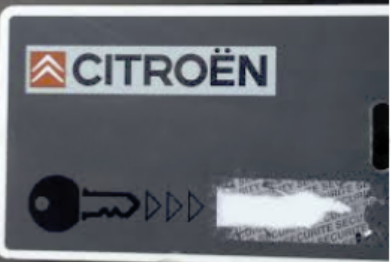

I only ever had my grey card like this:

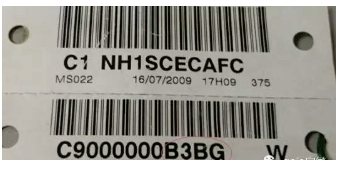

But is this the sort of thing you are referring to?
The last 4 digits of the bottom label would indeed appear to be the security code and the top one likely to be the key code for cutting a new blade.

That's the one, Marc. Good find.GiveMeABreak wrote: 02 Apr 2019, 16:33 But is this the sort of thing you are referring to?
(Note the last picture was from the web, so no link to any actual vehicle).
Mine was loose in the handbook and I didn't give it a second thought at the time.
