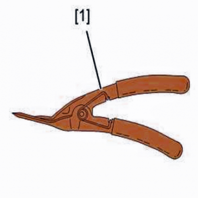

Here's the guide on removing the door card if you want to check the wiring there:
Tool to remove the door card clips

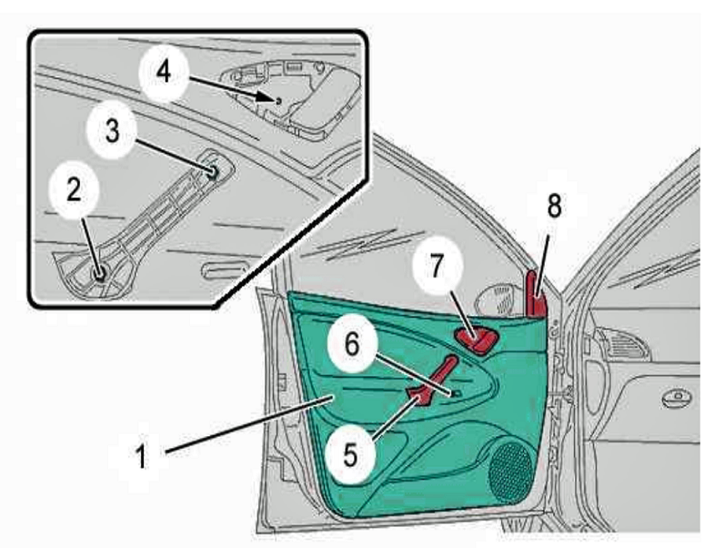

Remove:
  • Interior opening handle finishing moulding ( 7)
  • The door handle trim (5)
  • The electric window button (6)
  • The interior cheater (8)
  • The screws (2), (3) and (4)
Remove the panel with liner (1). (detach and lift the panel to disengage it from the window seal).
Unplug:
  • The speaker
  • The door sill lighting
This will give access to the wiring that you can inspect, which goes through the door grommet tot he engine bay.
