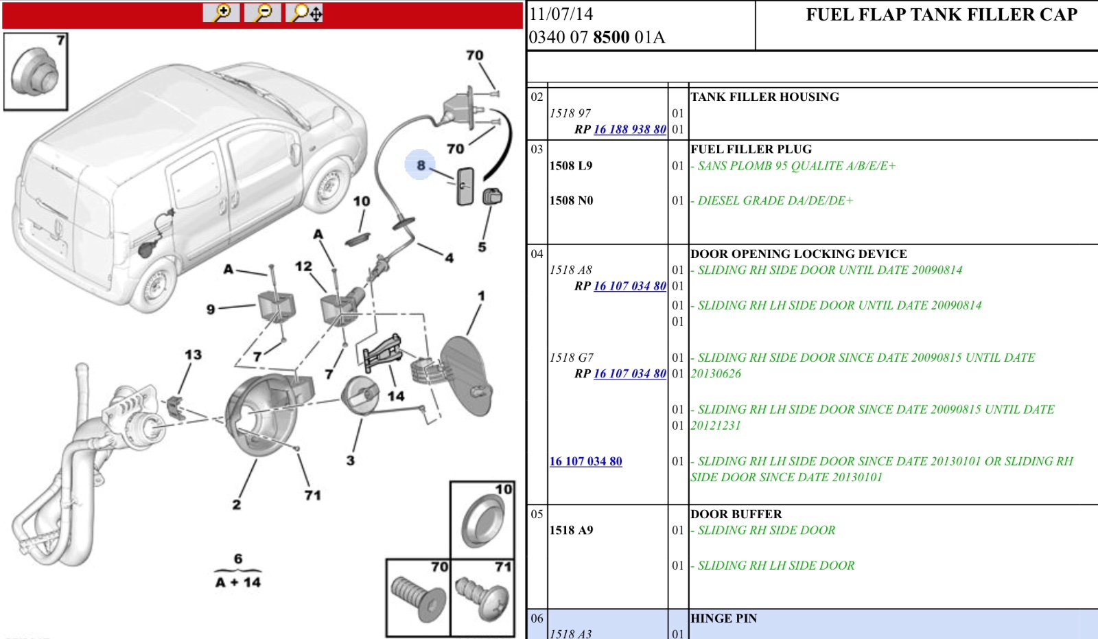

This is what you are referring to I believe...
I’ll have a look later to see if there is anything about access that I have.
vonsworld
- Posts: 18
- Joined: 14 Jan 2016, 09:34
- x 1
Re: Nemo sliding door lock not fully releasing?
That's it! Many thanks, at least I can now see what the mechanism looks like.

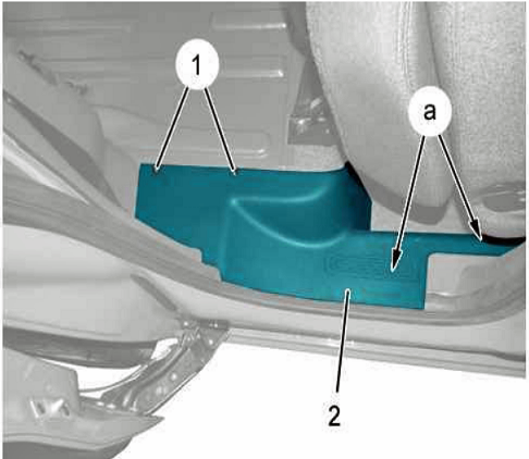

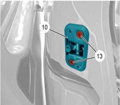

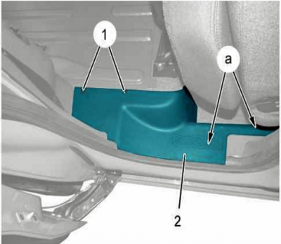

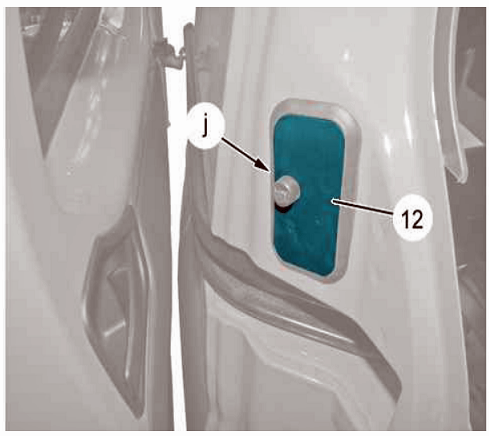

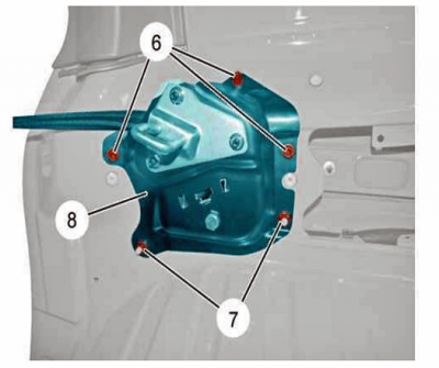

Here's the procedure anyway - I think it's a little more involved than you first thought
First you'll need to disconnect the battery - follow the battery disconnect / reconnect procedure to ensure correct initialisation of the ECUs:
BSI Reset / Battery Disconnect / Reconnect Procedure

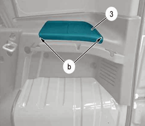

| Detach the sliding side door frame seal. Remove the bolts (1). Unclip: The rear door sill trim (2) (at "a"). Remove: The rear door sill trim (2). | Unclip and remove: The trim (3) (at "b") ; Using Trim Removal Tools. Remove the rear speaker (according to equipment) (See corresponding method). |
| Remove the cover and the rear seat belt anchor bolt (at "d"). Remove the bolts (5). Detach:
| Remove:

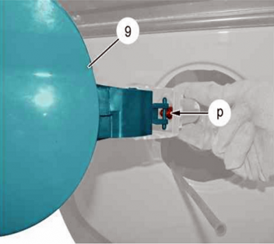

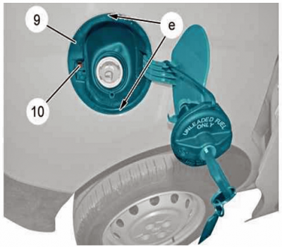

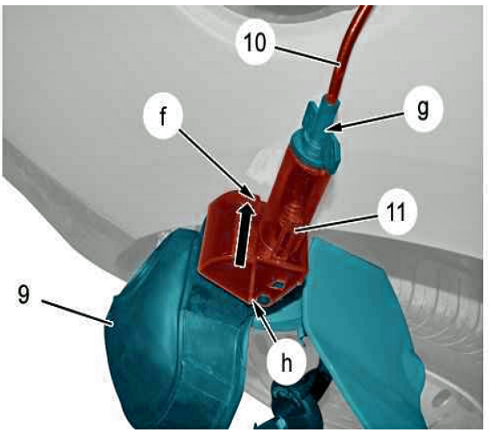

| Open fuel flap. Remove the bolt (10). Unclip and detach: The fuel filler cap (9) (at "e"); Using trim removal tools. | Detach the fixing (at "h"). Release the pin (at "f") (following the arrow ). Remove the fuel flap (9). Detach by giving a quarter turn (anti clockwise) (at "g"): The fuel flap blocker (10). Remove the hinge (11). |

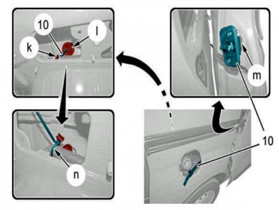

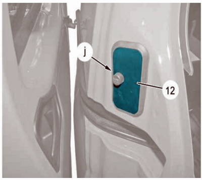

| Unclip the trim (12) (at "j"); Using trim removal tools. Remove the trim (12). | Remove the bolts (13). Detach: The fuel flap blocker (10). |
| Unclip: The fuel flap blocker (10) (at "k"). Cut the circlip (at "n"); Using a cutter. Release the grommet (at "l"). Release then remove the fuel flap blocker (10) via the aperture (at "m"). | Refitting CAUTION: Replace the fixing (at "n"). N.B.: On refitting, check that the fuel flap (9) is correctly positioned (at "p"). Proceed in the reverse order to removal. Tighten the seat belt anchor bolt to 3 m.daN. Reconnect the battery. Check the operation of the equipment. |

Thanks a lot for helping me out. Using your diagram I was able to open the door by inserting a screw driver between the door and frame to push in the safety bolt that was preventing it from opening. I have now cured the problem by undoing the mechanism in the door frame and disconnecting the cable. A simple job in the end and the car is ready for the MOT tomorrow!

Is anyone able to send an image of the safety bolt that I can aim my screwdriver at?
Same problem as my little one tried to open the door as I was filling up.
