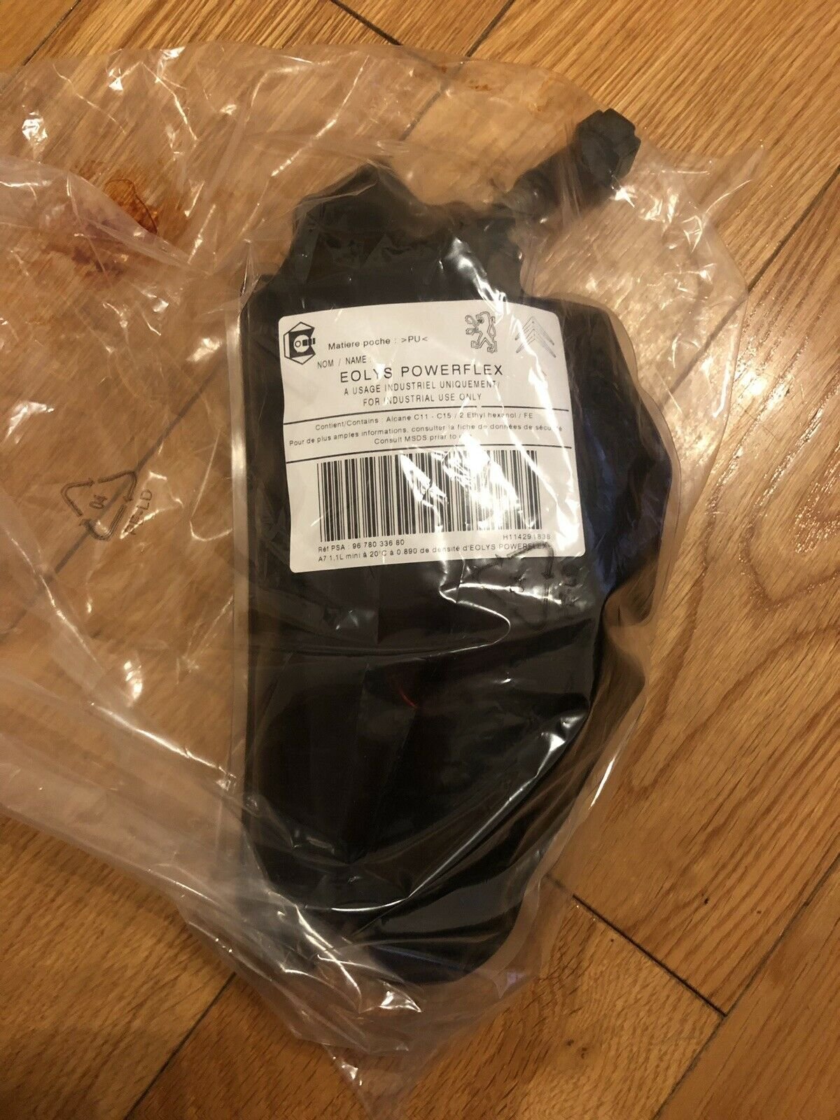

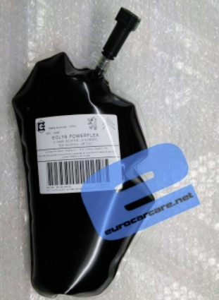

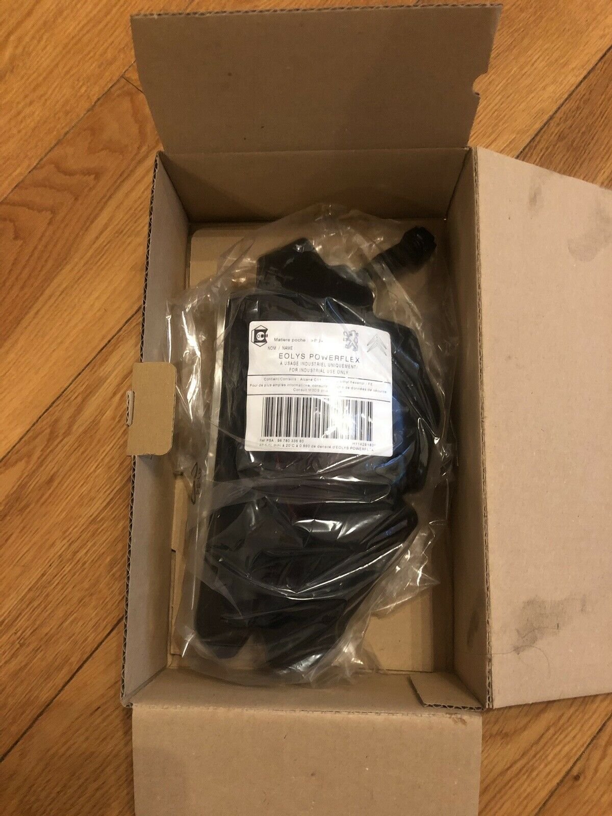

Right, your C3 Picasso uses a 1.1Lt Eolys Pouch. The correct additive is 'Powerflex' for your car. So you have a soft pouch that sits inside a hard shell casing.
The part number is: 9678033680. If you stick with this exact part number you cannot go wrong.
You can but this from Eurocarcare for £108.60 plus shipping:
