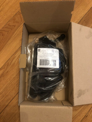

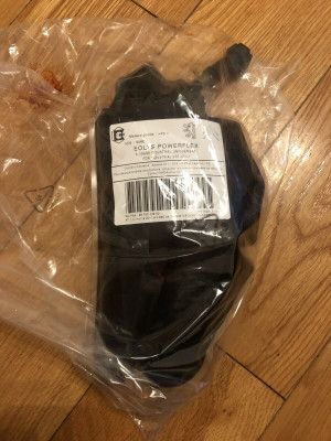

Right, your C3 Picasso uses a 1.1Lt Eolys Pouch. The correct additive is 'Powerflex' for your car. So you have a soft pouch that sits inside a hard shell casing.
The part number is: 9678033680. If you stick with this exact part number you cannot go wrong.
You can but this from Eurocarcare for £108.60 plus shipping:
http://www.eurocarcare.net/oil-and-flui ... pouch.html
Or from here for £128 inc. shipping:
https://www.ebay.co.uk/p/Genuine-PEUGEO ... 1233788205
You will have to get access to Diagbox though in order to reset the additive counter after the operation, so the ECU knows you have replaced it and to remove the warnings - because the volume remaining is not physically measured, but is estimated based on mileage, fuel quantity and amount of additive injected. Here's the one:
Unless the warning has come on the dash, I would leave it, as it is quite expensive and you may well have some fluid left to use. Once the warning comes on saying 'additive level too low' or similar, it will have worked out the mileage to the next due service - and determine if you will be able to make it before running too low. If it thinks you have too many miles to go before the next service, it will flash the warning on.
