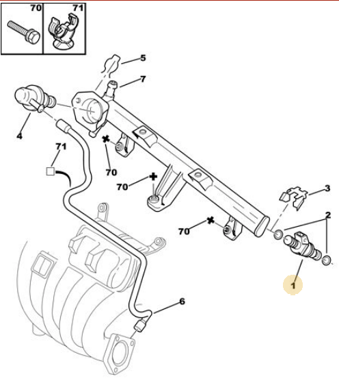

The part number on the injector is D7132MA . Do you know where can i find new injectors or find any other OEM brand that sells them.

Pop your VIN up and we can get the official part numbers.

The part was 1984A2 and is no longer available from Citroen.
Search 'Citroen 1984A2' in your browser and you should come up with some second hand ones.

It's a bit dangerous and risky to buy second hand. I found Bosch injectors 0280155809 TecDoc shows that this injector fits Citroen Xantia with the same engine that i have. XU7JP4. What do you think about that? Should I buy it? It is probably the same injector, isn't it>?

These are the PSA Injector part numbers for S1 & S2 XU7JP4 engines:
Xantia S1 (XU7JP4) Bosch - 198493
Xantia S1 (XU7JP4 LPG and Unleaded) - 1984A9
Xantia S1 (XU7JP4) Sagem - 1984A2
Xantia S2 (XU7JP4) Carburettor Pump Injector, EEC 2000 Depoll engine) - 1984C5
Xantia S2 (XU7JP4) EEC 95 Depoll Engine & Automatic Bosch - 198493
Xantia S2 (XU7JP4) EEC 95 Depoll Engine & Manual Sagem - 1984A2
Xantia S2 (XU7JP4 LPG and Unleaded) 1984A8
