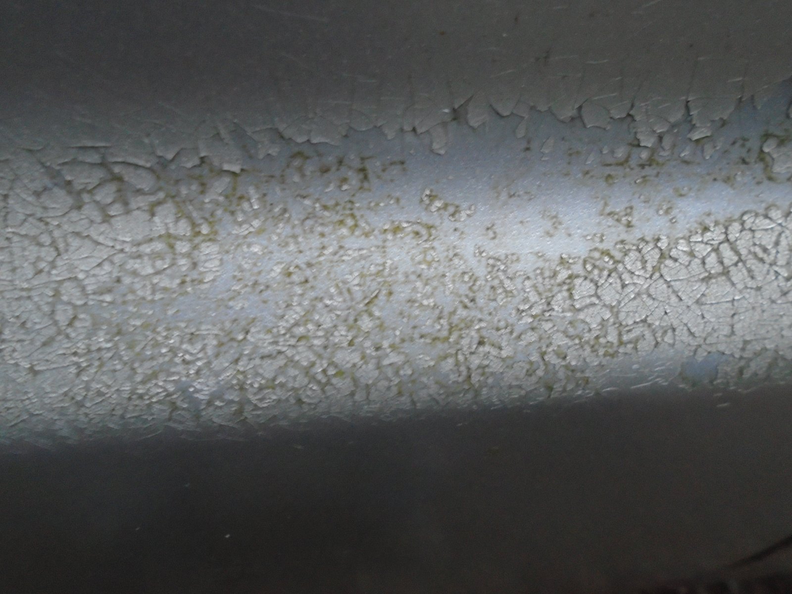

My latest bargain basement purchase has this purely cosmetic problem. It would be nice to sort it out. Its "Silver Blade" Metallic Paint and it is defective in a couple of areas like this....

That's a strip back to bare metal and start again job Neil.

I would say that has been put on to thick and in hot weather....top layer dried to quick, or, over a colour coat that had not dried...
