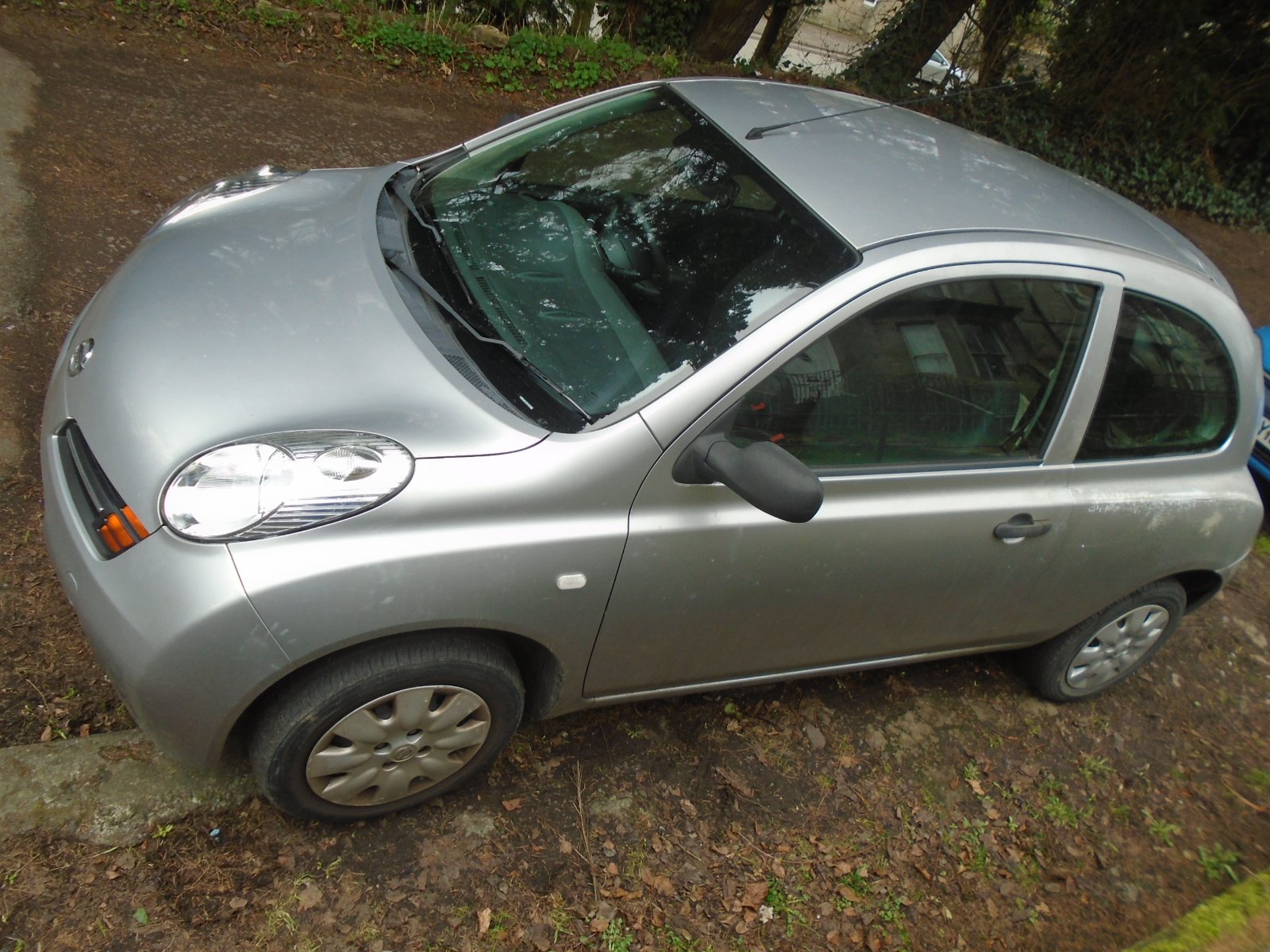

Thanks Gibbo. It's a Nissan Micra K12 Blade Silver 2005. Here it is here warts and all...

What ever way you go, pay attention to the 6p's! Far too many times I've ruined paint projects by rushing!
Silver is apparently The worst colour to match, but with a small hvlp paint gun and compressor you can get a good finish! I can't remember who I bought my last lot through, but a litre of clear' rfu' and an hvlp gun was under £35, i use it mostly for painting bikes, but have done a quick touch up on pops car,

With the Micra, I still havent got round to spending £40 at Halfords on the various cans needed to etch, prime, base coat and clear coat it, although I have primed myself for the task, with a few youtube videos should I ever get round to it.
